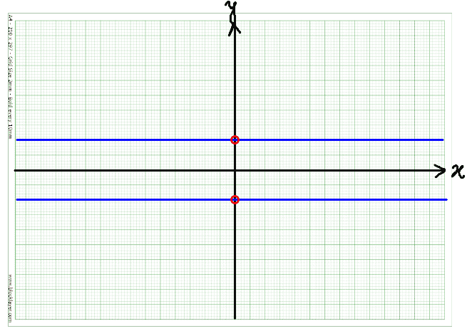

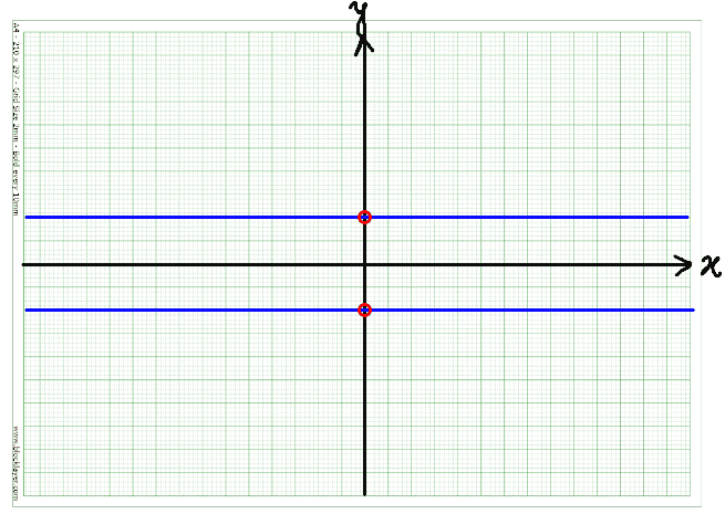

Indicate the points on the plane ##xOy## that satisfy the given equation : ##\mathbf{|y|x=x}##
By definition, the modulus of a number ##|x| = x\; \text{if}\; x \geq 0## and ##|x| = -x\; \text{if}\; x < 0##.
Given the equation : ##|y| x = x##.
Two conditions are possible :
(1) ##\underline{y\geq 0}## : ##xy = x\Rightarrow \boxed{y = 1}\; (x \neq 0)##. We note that except for zero, ##-\infty<x<+\infty## for this case.
(2) ##\underline{y < 0}## : ##-xy = x\Rightarrow \boxed{y = -1}\; (x \neq 0)##. We note that except for zero, ##-\infty<x<+\infty## for this case.
Hence the graph for this equation is (shown to the right) :
However, it is a different answer as given in the book (shown on the left).
As I have mentioned, ##x \in (-\infty, +\infty)\; \text{but}\; x \neq 0##. Hence I see no reason (for the book) to omit the negative values of ##x## for the solution ##y = 1## and the positive values of ##x## for the solution ##y = -1##.
Where am I going wrong with the reasoning? Or, dare I ask, is the book mistaken?

For this case, you have ##xy = x \Rightarrow x(y - 1) = 0## From this we see that x = 0 or y = 1. The first equation is a vertical half-line from the origin up (because ##y \ge 0##).

I don't understand their solution, either. Clearly the point (-1, 1) satisifies the equation |y|x = x, as does the point (1, -1).
Their solution would be correct if the equation had been |x|y = x.
Note that every point on the y-axis (i.e., x = 0) is also a solution. Your graph does not show these points.

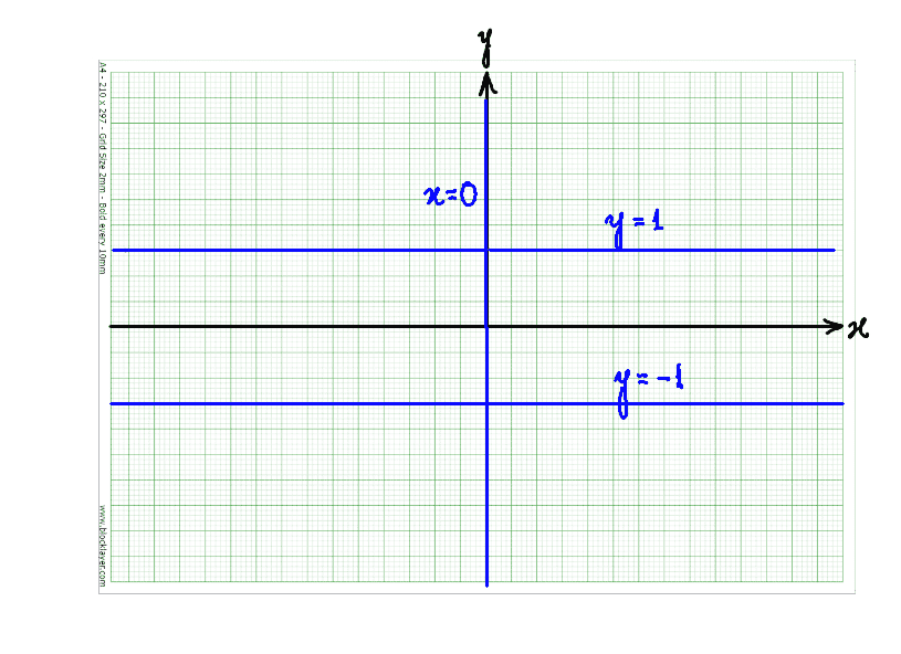

Thank you for your response @Mark44. I should do the problem again along the lines of what you said.
Problem statement : Indicate the points on the plane ##xOy## that satisfy the given equation : ##\mathbf{|y|x = x}##.
Solution : There are two possible cases.
(1) ##\underline{y \geq 0}## : For this case, we have ##xy = x \Rightarrow x(y-1) = 0 \Rightarrow \boxed{x = 0 \; \text{OR}\; y = 1}##.
(2) ##\underline{y < 0}## : For this case, we have ##-xy = x\Rightarrow xy+x = 0\Rightarrow x(y+1) = 0 \Rightarrow \boxed{x = 0 \; \text{OR}\; y = -1}##.
The graph for the ##\boxed{\text{boxed}}## solutions above is drawn below :
I hope this solution is ok. Please note that ##(0,1)## and ##(0,-1)## are both solution points of the equation.

You don't need to consider nine cases. Two cases are sufficient: ##y \ge 0## and ##y < 0##.
Case 1: ##y \ge 0##
The equation becomes ##yx - x = 0 \Leftrightarrow x(y - 1) = 0##
Then x = 0 or y = 1
These equations together with the assumption that ##y \ge 0## give the horizontal line y = 1 and the upper half of the y-axis from the origin up, including the origin.
Case 2: ##y < 0##
The equation becomes -yx - x = 0, or -x(y + 1) = 0.
Then x = 0 or y = -1. These equations together with the assumption that y < 0 give the horizontal line y = -1 and the lower half of the y-axis.
