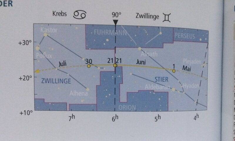

Roughly, how many degrees does the Sun (and the anti-solar point) move every day? And in which direction? How far does the Moon move in two days? And in which direction?
