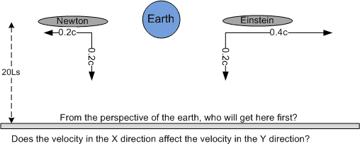

It was a running race between Newton and Einstein. I want to know who gets to the platform first.
Who will win this running race?
How many seconds are their scores?
This looks like a homework question - so, what do you think and why?
Questions I'd ask before even starting:
- are the velocities meant to be velocity components?
- are those components measured in the Earth frame?
- are the 'score' times supposed to be measured in the Earth's rest frame, or proper times, or what?
Hopefully the question specifies all this, since it's rather ambiguous without.
Yes, vx and vy.
Yes.
They are measured in the Earth's rest frame.
Thank you for the clarification. What is your attempt at this question? PF rules require you to show some effort before we help you - our aim is for you to learn how to do this, not for us to get some practice in.

What is "velocity" anyway? How is it defined?

That's not a definition; that's a description. When you say ##v_y##, how is that defined? What does ##v_y = 0.2c## mean?

vy: The speed of the spacecraft relative to the Earth in the y direction.
vx:The speed of the spacecraft relative to the Earth in the x direction.
And what is "speed"?
And what is the definition of speed, without using the word "velocity" in your answer.
speed = Displacement/time
Well, that's velocity, but anyway it proves the point. The y-component of velocity is, by definition, the y-displacement over time.
What can you conclude from this? Say, for example, that Einstein wins the race. What does that tell you about the y-components of velocity?

What does special relativity have to do with this question?
One scholar told me that the vertical velocity component is affected by the time factor.
rate = sqrt (1-v ^ 2 / c ^ 2), so relative to the earth, the speeds of the two spaceships have become
vy1 = 0.2c * rate1, rate1 = sqrt (1- (0.4c) ^ 2 / c ^ 2)
vy2 = 0.2c * rate2, rate2 = sqrt (1- (0.2c) ^ 2 / c ^ 2)
Then he told me that the distance was 10Ls, so the last one to arrive was the one with the smaller vx, which was Newton's first arrival. Do you think his answer is correct? I don't understand.

As I said, this goes back to the definition of velocity. Your original diagram shows the velocity in the Earth frame- yes? It shows the distances in the Earth frame - yes? Time is going to be measured in the Earth frame- yes?
Either the y-velocity is ##0.2c## (in the Earth frame) or it isn't. If it is, then that's what you use. If it isn't then your data is wrong. If, let's say the y-velocity of Einstein is less than ##0.2c##, then that's what you should have on your diagram. Surely?
Special Relativity only applies if you want to analyse the race in a different frame. Since you don't, any transformation of lengths, times and velocities is utterly irrelevant.

It's a draw by definition of (component of) velocity. Two objects with the same y-component of velocity have the same y-displacement in the same time. By definition. Assuming all data applies to a single reference frame.

The platform is stationary relative to the earth.
Then it has the same simultaneity.

In the reference frame of the Earth and platform, were both start simultaneously with the same vertical velocity.

As A.T. points out, observers at rest or only moving parallel to y in the Earth frame (such as Earth and your platform) will regard this race as a draw. Observers with any motion in the x direction in the Earth frame (such as Newton and Einstein in your example) will get different results for who won.
It isn't clear from what you've said which frame your astronomer was using. He may have made a mistake, or interpreted your question differently, or he may be using a different frame from the one you think he is.

Let's assume that Newton reaches the platform in ##100s## (Earth frame). He has traveled ##20## light seconds in the y-direction in ##100s##. That's ##0.2c## for the velocity component in the y-direction. By definition.
Let's also assume that Einstein reaches the platform in ##50s## (Earth frame). He has traveled ##20## light seconds in the y-direction in ##50s##. That's ##0.4c## in the y-direction.
That's what velocity and components of velocity mean. You calculate them by taking y-displacement over time. If Einstein does not reach the platform in ##100s##, then the y-component of his velocity is not ##0.2c##. There can be no argument about this.
