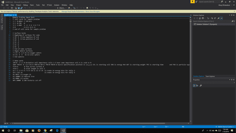

Hello,
I am working through the MCNP6 manual and am experiencing the following error as well as warning when trying to run the sample problem from the manual.
The fatal error I get is
"fatal error. 1 entries not equal to number of cells = 4."
From the IMP card. My entry for that card is
IMP:N 1 1 1 0
which is exactly what they have in the manual.
After that I get the following error.
"warning. Default xsdir_mcnp6.1 not found. Switching to backup, xsdir
bad trouble in subroutine ixsdir of imcn
data file xsdir does not exist"
But I do see xsdir in the MCNP_DATA directory so I am a bit confused about that. I have upload the output file with the errors in case I have not properly explained what's going on.
hi
for your fatal error it is because you have twice "imp:n". one in line 22 and the other line 23. Remove line 22.
In MCNP6 "Xsdir" must be named "xsdir_mcnp6.1" so renamed the file "xsdir". But it is Strange I think that MCNP6 was not install correctly.
This is very strange. As you can see from the screen shot below IMP:N is only in line 24. I think I will uninstall and reinstall and see if that helps. Thanks for your help.

sorry,
too difficult to read. Can you copy/paste your file (or put a ascii file) ?
Here it is a a notepad file. Thank you for looking at it.
I wanted to add that I looked and the file "xsdir_mcnp6.1" does exist in the MCNP_DATA folder.
first you have 2 imp:n !
in block 1
Sample Problem Imput Deck
C cell cards for sample problem
1 1 -0.0014 -7 IMP:N=1
2 2 -0.786 -8
3 3 -1.060 1 -2 -3 4 -5 6 7 8
4 0 -1:2:3:-4:5:-6
C end of cell cards for sample problem
must have
1 1 -0.0014 -7 $ IMP:N=1
second you have a cukie cutter :
instead of
C Surface Cards
C Begining of surfaces for cube
1 PX -5 $ 5cm negitive of x=0
2 PX 5 $ 5cm positive of x=0
3 PY 5
4 PY -5
5 PZ -5
6 PZ 6
C End of Cube surfaces
C Begin Sphere Surfaces
7 S 0 -4 -2.5 0.5 $ oxygen sphere
8 S 0 4 4 0.5 $ iron sphere
C End sphères
you msut have :
5 PZ 5
6 PZ -6
and after it's ok (see file)
