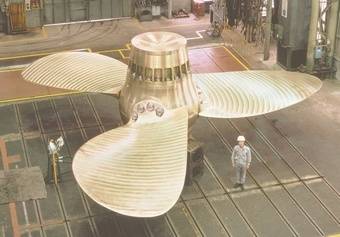

For one thing, ship propellers and aircraft propellers operate at vastly different speeds. If you spun a ship propeller at the same speed as an aircraft propeller, the ship propeller would start to cavitate, which means that bubbles of water vapor would form on the low pressure side of the blade. These bubbles disrupt the flow of the water over the blade, and the propeller cannot absorb the power it is designed to do. These bubbles also collapse quite violently, leaving the blades eroded and damaged where this occurs.
Ship propellers also tend to be big. Here is a propeller which is 11 m in diameter:
It would be tough to fit such a beast on a Cessna.
