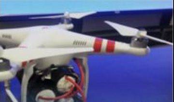

Here is one popular, low cost, design. The "high cost" design I've seen is where the pitch starts out high near the hub (sometimes also with increased area) and decreases toward the tips.
