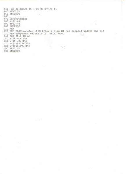

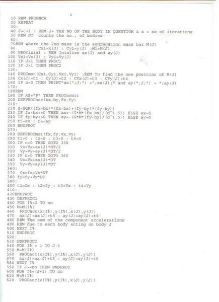

I had to give this a miss for nearly 8 months as I had not much time to myself. I have changed it to a n-body problem, but it does not work correctly. When I use it as a two-body problem e.g., M(1)=moon's mass=7.35E22, M(2)=Earth's mass=5.98E24, x(1)=-3.844E8, y(1)=0, x(2)=0, y(2)=0, Vx(1)=0, Vy(1)=1.023E3, Vx(2)=0, Vy(2)=-12.57, I get a horizontal line on the graphics screen with the moon oscillating back and forth with an increasing ampitude, not a circular orbit. In fact to get a circular orbit I must make Vy(1)=2.8E9, and Vy(2)=-3.44E7. All velocities are in m/s, coordinates are in metres, masses in kg. I will sumit the relevant parts of the program later today. Thanks for the help.
I have had very little time to myself for the last 8 months, so I hadn't time to work on this thread. I have updated it to the n-body problem, lately. On testing the program with the two body problem it fails to work correctly. E.g., when I let M(1)= moon's mass=7.35E22, M(2)=Earth's mass=5.98E24, x(1)=-3.844E8 (which is the distance of the Moon from Earth), y(1)=0, x(2)=0, y(2)=0, Vx(1)=0, Vy(1)=1.023E3 ( the speed of the moon around the earth), Vx(2)=0, Vy(2)=-12.57; I get a horizontal line with the Moon oscillating back and forth with increasing amplitude per cycle. In fact to get a circular orbit I must make Vy(1)=2.8E9 and Vy(2)=-3.44E7, Which are values greater than the speed of light!
Where coordinates are in metres, [speed]=m/s, [mass]=kg. Please see attachments. Thanks for the help.
  • Screenshot of BASIC source code listing lines 630 to 800, including procedures ENDPROCinitial and PROCtransfer that copy component values x(I), y(I), Vx(I) and Vy(I) into old-value arrays.
  • Screenshot of BASIC source code for an n-body gravity simulation, with REM comments and procedures PROGNCA, PROCinit, PROCmot, DEFFNacc and DEFPROCcol.
Just a few additions to the attachments:line nos:
191 IF J=no THEN PROCtransfer
192 PROCinial
199 UNTIL orbitiscomplete
