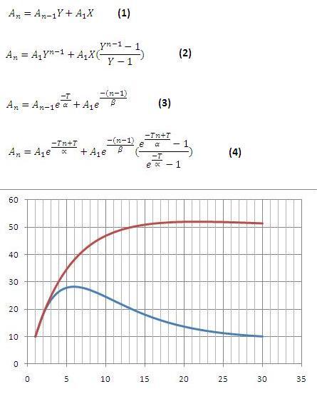

What am I doing wrong?
When you have an equation such as the one displayed in Equation 1 (see attached figure) and want to compute it by hand, you may rewrite it as Equation 2.
Setting X and Y to the following values:
X = Exp[-(n-1)/beta]
Y = Exp[-T/alpha]
I got Equation 3. Thereafter, I tried to transform it in the same way, and then I got Equation 4. However, Equation 3 and 4 are not the same. For alpha=360, beta=5, A1=10 and T=1, these two equations give very different curves, as you can see at the bottom of the image (Equation 3 represented as the purple curve, and Equation 4 represented as the blue line). What am I doing wrong?
Thanks in advance,
Estevão

  • Four stacked equations labelled 1 to 4 for a recurrence A_n, followed by a line graph of two curves against n from 0 to 35, rising then falling; the red curve peaks near 52 and the blue curve near 28.

Here's a hint Lucas. Go back and have a look at how you derived equation 2 from equation 1. Notice that to get it in the form of a geometric series you had to factorize out the X's and Y's across the sum of multiple terms. Think about what that means about X and Y, they must be constants, neither can depend on "n".
You are right! Thank you very much for the answer. However, now I have a new problem: how to simplify Equation 3 so I can compute it by hand?
Have you ever used Z-Transforms LucasGB? There are many ways to solve difference equations but z-transforms are one of the easiest.
See : http://en.wikipedia.org/wiki/Z-transform
I'll leave some of the work to you, but I get an answer that exactly matches your "red curve" and it's in the form of :
[tex]A_n = \frac{A_1}{b-a} ( b^n - a^n )[/tex]
where "a" and "b" are constants in terms of your alpha, beta, T etc.

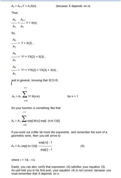

LucasGB, I think there is no need of Z-transform.
Look at the attached picture.
I hope it will help you.
(Sorry, in the picture, when it says "knowing that X(1)=0", it should say "knowing that X(1)=1"
  • Handwritten-style derivation of a recurrence solution: A_n = A_(n-1) Y + A_1 X(n), ratios A_n/A_1 expanded for n=2,3,4, then A_n = A_1 sum over k of Y^k X(n-k) for n>1, followed by the closed form with exponentials and the geometric series result A_n = A_1 exp[-(n-1)/beta] times a geometric sum expression, labelled (A).
Thank you very much, Karlx. This is a very creative way to solve the equation. You and uart helped me a lot!
