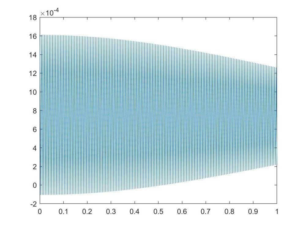

I used a Crank-Nicholson method to solve a radially symmetric heat equation. I get some odd results. I'm not sure if it's my 1) Numerical scheme, 2) Parameters chosen or 3) Code which is wrong.
Hi,
I am solving the radially symmetric heat equation with an internal heat source(this is meant to model the heating of a cylindrical battery). It's meant to model heat in a cylinder with conduction to the environment, so my outer boundary condition is Newton's law of cooling. The $T$ in the equation is excess temperature from the environment. I used a Crank-Nicholson which I think I've got right. I plotted a cross-section to see if it looked okay and it didn't basically and now I'm not sure what's going on. I've checked my code, and it matches my numerical algorithm. I think I have my physics correct but again I could be wrong. My code is:

Can anyone see where I have made a glaring error?

I think the issue here is how you handle the boundary conditions, in particular, the boundary condition at r = 0.
I would approach the formulation of the difference equations a little differently from the way you have done it. It would be a two step process, first using the method of lines to discretize the differential equation spatially into a coupled set of 1st order ODEs in time, and then secondly to apply the Crank Nicholson formalism to the set of ODEs.
I will only show the first step here. The 2nd step is then obvious. So, applying the 1st step to the general region, I get $$\frac{dT_j}{dt}=\alpha \frac{T_{J+1}(1+1/(2j))-2T_j+T_{j-1}(1-1/(2j))}{(\Delta r)^2}+q$$where ##\alpha=\kappa/\theta## and ##q=Q/\theta##
Now for the BC at r = 0. Since dT/dr is zero there, we can approximate the temperature profile in the vicinity of r = 0 by a series of quadratic accuracy $$T=A(t)+B(t)r^2\tag{1}$$, with ##T=T_0## at r = 0 and ##T=T_1## at ##r=\Delta r##. So ##A=T_0## and ##B=\frac{T_1-T_0}{(\Delta r)^2}##, From Eqn. 1, it follows that $$\frac{1}{r}\frac{\partial}{\partial r}\left(r\frac{\partial T}{\partial r}\right)=4B(t)$$. So, for the BC at r = 0, the spatially discretized differential equation becomes: $$\frac{dT_0}{dt}=\alpha \frac{4(T_1-T_0)}{(\Delta r)^2}+q$$This is how the 2nd order accurate spatially discretized boundary condition should be applied at r = 0.

The method of lines is just a process for deriving the finite difference discretization in a two step-process, by first discretizing with respect to the spatial parameter and then discretizing with respect to the time parameter. It should deliver the exact same Crank-Nicholson finite difference equation(s). I will derive the Crank-Nicholson finite difference equation using your parameters and demonstrate that it is exactly the same.
Your starting differential equation is
$$θ\frac{\partial T}{\partial t}=\frac{\kappa}{r}\frac{\partial}{\partial r}\left(r\frac{\partial T}{\partial r}\right)+Q$$​
The spatial finite difference discretization of this is:
$$\theta \frac{dT_j}{dt}=\kappa\left[\frac{T_{j+1}-T_{j-1}}{2r_j\Delta r}+\frac{(T_{j-1}-2T_j+T_{j+1}}{(\Delta r)^2}\right]+Q=
\kappa \frac{T_{j+1}(1+1/(2j))-2T_j+T_{j-1}(1-1/(2j))}{(\Delta r)^2}+Q$$where, in the second term of the rhs, we have made use of the relationship that rj=jΔrrj=jΔr.
I can now see that you have an error in Eqn. 4 of your write-up. There should be a 2 in the denominator of the 1st- and the 4th terms in brackets. Do you see that? So the value of your parameter B should be ##B=\frac{\kappa \delta t}{4\delta r}##, not ##B=\frac{\kappa \delta t}{2\delta r}##.
I will continue after we get agreement on this.

I found some sign errors in your algebra in going from Eqn. 12 to Eqn. 14. Please check.

If you didn't make any mistakes, it would work. Try a calculation in which you use only 21 grid points and choose delta t such that it makes alpha close to 1.
I have some ideas on how you can proceed to get your CN program to work properly.
Phase 1: To test out your spatial finite difference scheme, solve the problem using forward Euler (rather than CN ) with a small enough step size that the solution remains stable.
Phase 2: Use the CN equation, but solve the matrix using predictor-corrector (successive substitution) at each time step, rather than matrix inversion. The predictor for the first time step would be forward Euler. The corrector equation would involve only the diagonal elements, while the other values at the end of the time interval would be those from the previous iteration. Iterate at each time step until the corrector has converged.
I also recommend for debugging purposes that you do all these tests with only 3 spatial grid points. The CN solution at each time step would then require the solution of only 3 simultaneous linear equations, which could be done by hand (to check that the matrix was set up and solved properly).
