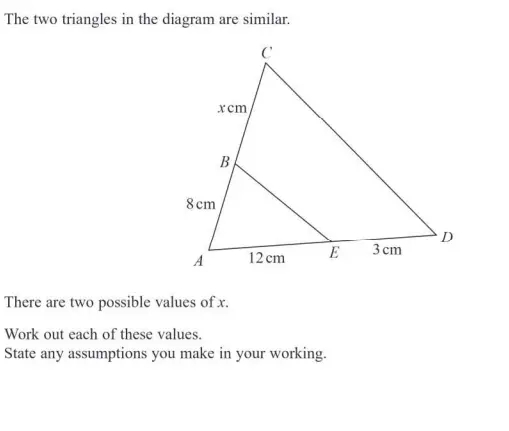

paulb203 said:
Homework Statement: See screenshot in main body
Relevant Equations: I don't know if there is a generic equation
Maybe something like AB(SF)=AC ?
Why are there two possible values of x?
Here's what I've done so far.
AE(SF)=AD
12(SF)=15
SF=15/12
=5/4
AB(SF)=AC
8(5/4)=AC
AC=10
AC-AB=x
x=10-8
x=2
A hint please, as to my next step
You are assuming that there is only one way the triangles can be similar ... the drawing leads you there ... I suspect you need to evaluate the words and make your own drawings.

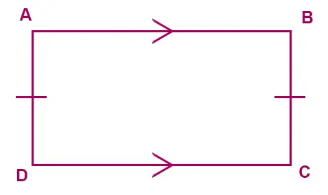

  • #68
fresh_42 said:
... plus, there is a symbol available in geometry to show parallelity in pictures. //
You mean >
  • #69
What surprised me was that there seem to be more than 2 ways the triangles can be similar, but they yield only 2 results for the question asked. Did this surprise anyone else? Or am I wrong?
  • #70
DaveC426913 said:
You mean >
I know it with two short lines, but anyway. If the sides were parallel, there would have been a possibility to mark it accordingly.

I've not encountered that notation.
Where I come from, | means equal length. To-wit:
AB and DC are parallel.
AD and BC are of equal length.
  • #77
mathwonk said:
Same here in Britain (and since the OP seems to be preparing for GCSE this is the notation that they would see).
Though maybe @fresh_42 means not on the diagram but when referencing the lines. E.g. I have seen the notation ##AB\parallel CD## before.
