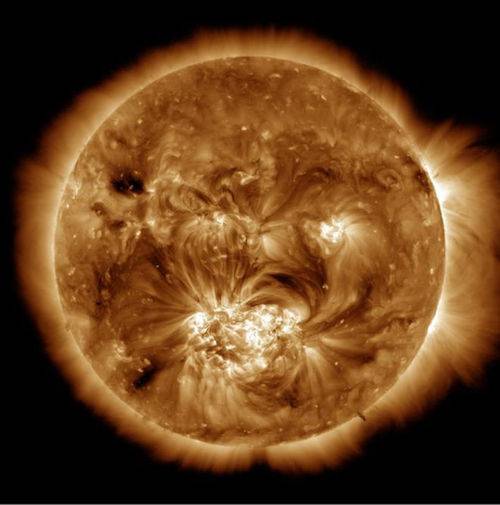

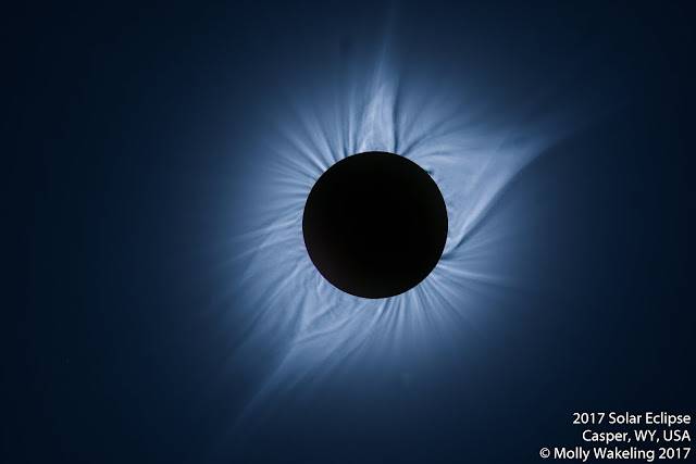

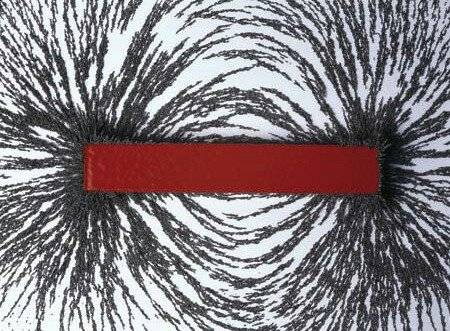

You can't photograph magnetic field lines directly, but you can see their impact. On Earth, you will see photos of magnetic field lines imaged by using iron filings that align to the direction of the field lines, like the attached. In space, plasma clusters along magnetic filed lines and outlines where the field lines are , like these photos of the sun.
Thanks. Nice to have pictures of what I'm talking about.

The lines represented by iron filings on a magnet look real enough.
They aren't really field lines, though. The iron filings affect the magnetic field go they tend to align. So you're seeing lines of iron filings aligned with the field.
Also, you will get a different set of lines every time you do the experiment. The general shape of the lines will be the same, but the exact pattern depends on the fall of the filings.
