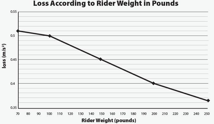

Oh.. and WVU gives the following empirical data for "losses" as a function of mass on the zip line... Why does the curve go down and not up?
A typical "zip line" or "flying fox" set up (from WVU)...
Just to add, this curve is interesting. It is essentially kinetic energy lost per unit mass of the person. If you took the y-values on the plot and multiplied by half the person's mass, you would get mv2/2, which would equal the kinetic energy lost by the person to friction, etc.
JBA said:
It appears to me that the change of cable angles due to the increased weight would have little beneficial effect because apply a point loading to the cable beyond the top cable connection point, the accelerating region, increases the cable angle behind that point load but also reduces the downward angle between that point and the bottom apex of the cable and past that bottom apex point, the decelerating region, the point loading increases the upward angle of the cable to the bottom connection point.
You're right. It probably would have minimal effect on the losses. It would probably increase peak speed due to their dropping further, but at the end of the track (where everyone reaches the same height), it would have no effect.
