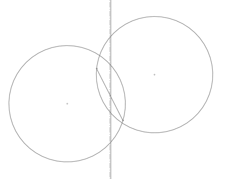

I'm trying to design a simple mechanism in CAD and got stuck on this problem.
Consider a lever (blue shape) that pivots at one end (blue circle). The other end rests on a piston (pink rectangle). In my application the lever is pushing the piston (the lever pushes through the full travel of a button under one end), but it's the same problem if the piston moves the lever.
If the lever is a thin straight line, the end of the lever would rub against the top of the piston as the piston moves up or down. These parts are going to be unlubricated plastic, and rubbing might result in some wear after a few thousand cycles.
I'm trying to figure out an approach to calculate points along a curve on the underside of the lever to approximate rolling friction, to minimize the rubbing as the lever and piston move through a small range of motion. At the top of the piston's range, the lever would start horizontal or nearly so, and the lever's angular range of motion is at most 25°.
As the piston moves down, the lever would need to lengthen to maintain the same point of contact, which implies some sort of curved surface, as shown in the drawing above. I know it can't maintain the same contact point and have rolling friction, so the curve should lengthen the lever and allow the lever's underside surface to roll across the piston surface.
The more I think about it, the more it seems like I need to calculate this numerically. That isn't a problem (I do such calculations in the CAD software for other purposes), I just don't know how I would set up this particular problem. This seems like such a common application, it must have been dealt with before, but I don't know what to search for information that would help.
Two scenarios:
1) The lever is curved such that it contacts the center of the piston over its full range of travel. In that case, the piston is always loaded in the center, while the lever must slide against the top of the piston.
2) The lever is curved such that it rolls across the top of the piston. In that case, the piston is loaded off center over all but one position of the lever. Off center loading puts loads on the sides of the piston. The magnitude of those loads depend on the length of the piston.

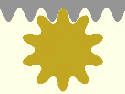

I do not have a solution for the curve to get rolling action off the top of my head, but your problem seems to be similar to that of an involute tooth gear rolling against a rack. The teeth of the gear are curved, while the teeth of the rack have straight sides. The gear teeth have a profile designed to minimize sliding action, but there is always some sliding action. The sliding can be minimized by proper gear tooth design, but cannot be eliminated.
I think that your case is very similar. If so, you can minimize, but not eliminate sliding. If you decide to live with sliding, give us more information on the application, and we can help you select an appropriate plastic.

Good analogy with gear teeth. The only kind of gear teeth I know of that are supposed to have only rolling friction are those cut using a rack with cycloidal teeth. A while back I attempted to make one for 3D printing:

... but your problem seems to be similar to that of an involute tooth gear rolling against a rack. The teeth of the gear are curved, while the teeth of the rack have straight sides.
That is the key to the solution.
Unlike the simulation you show, the shape of an involute gear tooth, depends on the diameter of the gear. The rack has a flat face, as does the hob that is used to generate a circular gear wheel in a hobbing machine.
Note that with the rack and pinion example in post #2, the top of your piston just needs to be slanted and the solution applies directly to your case.

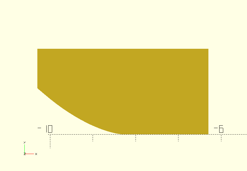

@jrmichler @Baluncore Thank you. The gear-cutting concept worked. Instead of deriving a formula for a curve, all I had to do is use my CAD software to cut the top of the piston out of the pad on the end of the lever at several orientations in which they would come into contact. I used the center of the piston and lever pad as the center of the "gear teeth" height, and rotated the lever while the piston moved, making cuts into the pad along the way. The result is a nice smooth curve, for the case of the lever pivot being level with the piston at the top of its travel (pivot is way off past the right of this image):
As this pad pushes down on the top of the piston, it rotates counterclockwise and should rub minimally.
If I allow the piston to rise above the lever's pivot, then the other side of the pad gets cut, leaving a sharp point a little to the left of where the curve leaves the X axis.
