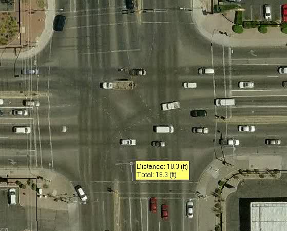

Let me clarify what happens.
On a plain old suburban road (in the outskirts of a major metropolis), at an intersection with smaller side roads, there will be traffic lights. These in are very common where I live. A main residential road will have a traffic light every half dozen blocks or so. Despite being a main road, the traffic is not at all heavy except perhaps during rush hour. Few pedestrians are likely to be around.
Main road traffic light is green, pedestrian crosswalk says Walk.
Then, with no one around, the pedestrian crosswalk signal will turn to Don't Walk and begin counting down from about 20. When it reaches 0, it changes back to Walk, and the traffic light stays green (instead of changing to yellow as one would expect in preparation for a stop).
This happens routinely despite the complete absence of cross-traffic or pedestrians.

1] Typical main residential road traffic light with pedestrian crossing. No cross traffic, no pedestrians. Also just as common in Mississauga though miles of commerical strip mall wastelands and light industrial zones.
2] Light pattern.

DaveC426913 said:
The pedestrian cross walk wasn't counting down to anything.
It should have been counting down to a solid "Don't Walk" signal. Somebody goofed up on programming your city's lights.
Somebody goofed up on the programming in my city, too. Here those countdown timers count down to when the cross traffic will get the green light. This is even dumber than your city's fouled up signals. Would-be race car drivers in my city in their souped up pickups watching the crosswalk countdown rather than cross traffic. When the timer hits zero, they go. Some slow pedestrian is going to get hit.Here's how they work in Lincoln, Nebraska:
I'd argue that even this isn't optimal. Other cities have the countdown while the sign still shows "Walk", and the countdown is to when it switches to "Don't Walk" -- well before the light changes from green to yellow. People walk at about 1/10 driving speed. The intersection needs to be clear of pedestrians by the time the light changes to yellow.

I don't believe somebody screwed up. It is like this at uncountable intersections and has been so for years.
DaveC426913 said:
This is how they work here too.
Then they are working right.
You are ignoring the ~factor of 10 speed difference of a walking pedestrian versus a car zooming through a yellow light. The walk signal needs to turn to "Don't Walk" well before the traffic signal turns to yellow.

D_H, you are not doing your homework.
The traffic light never changes from green at any point.
The pedestrian crossing signal simply spontaneously (with no cross traffic or pedestrians present) decides to change to Don't Walk and count down. When it reaches zero, it changes back to Walk without the main traffic signal ever changing from green.

That is not the way the signal to which I linked works, and to which you said that that is how your signal works. The signal I linked to switches from "Walk" to flashing "Don't Walk" with a countdown to a solid "Don't Walk". So which is it -- The way the signal to which I linked works, or the way you said?
If the walk signal turns back to "Walk" after the countdown is complete, I would say that somebody messed up programming the signal. That somebody is someone who works for your city's government. I doubt the quality of city-level civil servants varies that much from the US to Canada.
I think Dave is talking about the main (car) traffic light not stopping cars for the pedestrians? I.e. the pedestrian programming cycle is still like normal, but it's not synchronized with the car light.
