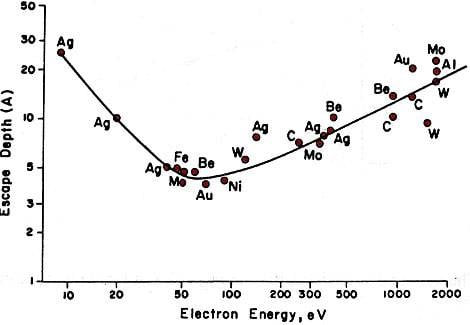

A proton passing through a solid will excite a huge number of electrons, but the energy distribution of the electrons is given by
[tex]\frac{dn}{dE}\propto \frac{1}{E^2}[/tex]
So most of the electrons excited in a solid will only gain a small amount of energy, and won't be enough to cause ionisation, see p26 in the pdf here. Such small energy processes aren't possible in gases as gases don't have a continuous density of states like solids do, as such the only processes that are allowed are those that result in transitions between the discrete energy levels and those that cause ionisation.
Note also that the mean free path of a free electron in a solid is also extremely short, a few nanometres usually, so any ionised electrons would likely not make it out of the solid to be detected.

But if this is true, then we also won't have core-level photoemission, which is clearly not the case here. Or what about Auger process?
