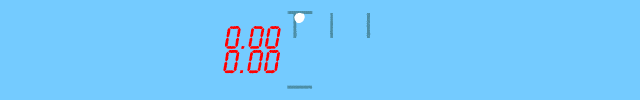

Others here have pointed out the Relativity of Simultaneity issue. You can eliminate that by considering the "round trip" time of the light, The light leaves one end of the car, reflects off the other end and back to the first. You have basically set up a light clock "that is on its side".
Here is an illustration of a scenario where you have light clocks set up perpendicular to each other:
Here, the ( the expanding circle illustrates how all the light pulses initially emitted travel at c relative to rest frame of the animation. )
While the two legs of the round trip from the vertical pulse are equal in duration, the horizontal legs are not, but the summed duration of vertical vs horizontal pulses are the same.

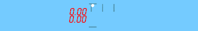

Here, the ( the expanding circle illustrates how all the light pulses initially emitted travel at c relative to rest frame of the animation. )View attachment 275687
This is incredibly helpful. Thank you!
