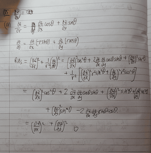

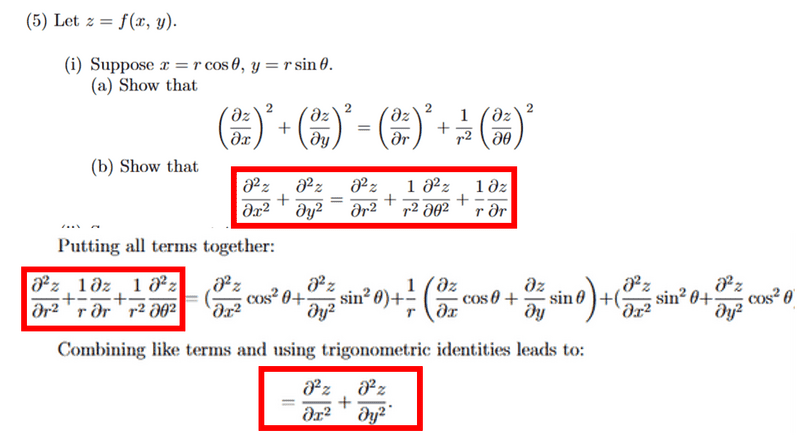

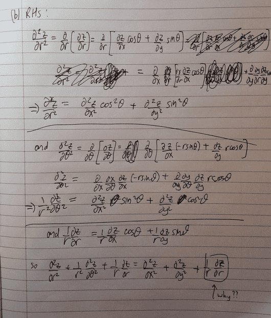

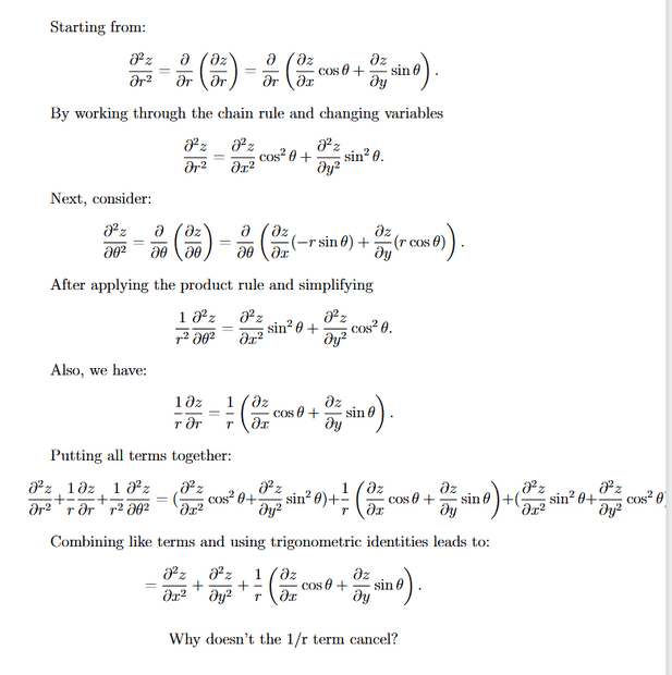

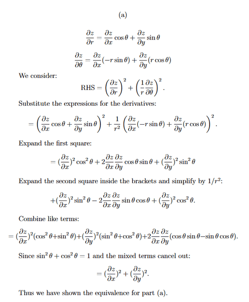

Part (a) is fine. I have attached my work for this here anyway because I use the first two lines of (a) in my proof of (b). In part (b), I get the extra factor of ##\frac{1}{r} \frac{\partial z}{\partial r}## and I don't know why. Can anyone help? I am unable to figure out the flaw in my steps :(

Sorry, I don't see any difference between the problem-statement equation (top box) and your derived equation (bottom boxes):
my bad I have edited #3

The partial derivative of ##z## wrt ##x## is a function of both ##x## and ##y##. The second order derivative of ##z## wrt ##r## should have terms like ##\frac{\partial^2 z}{\partial x \partial y}##.
Try ##f(x,y) = xy## as an example to check your working.
That said, the cross terms cancel. But, you are also missing the terms arising from the product rule when taking the second derivative wrt ##\theta##.
Good catch, it all works out now, thanks!
