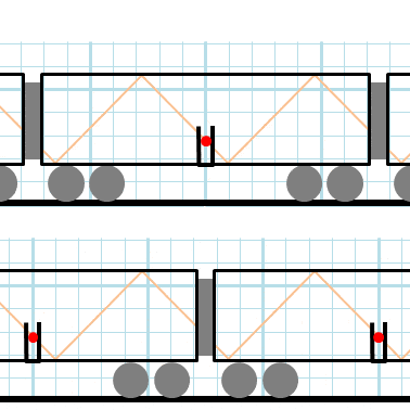

Let me try to interpret the question in a way that makes it sensible.
We [think we] have a stationary laser and a stationary target. Our lab is sitting on the equator. The laser is pointing due south. We set up a target directly to the south of the laser. We fire the laser and it strikes the target dead center.
Naively, this makes sense. But what about the rotation of the earth? If the beam was travelling due south, and the target was moving, shouldn't the beam have to lead the target to ensure a dead center hit?
Yes, indeed, if we drop our pretense that our lab is stationary and adopt the idea that it was actually moving to the east at 1000 miles per hour or so then a light pulse fired by the moving laser will follow an eastward-slanted path, even though the laser is pointed due south.
If we look carefully at the internals of the laser, we can see that this is a result of the relativity of simultaneity. The leading edge of the laser will emit the pulse a fraction of a second later than the trailing edge. (Leading clocks lag). The result is a slanted wave front and a pulse that travels at an angle.
If one collimates the beam with a different mechanism, the aberration angle will be the same, though the mechanical explanation may be different.

Light has an invariant speed. So what? That doesn't mean that you can't hit something with a laser.
Maybe this animation from a 10-year old post will help.
DrGreg said:
Even though the ceiling of the train is moving relative to the track, the ball hits the same point on the ceiling every time.
