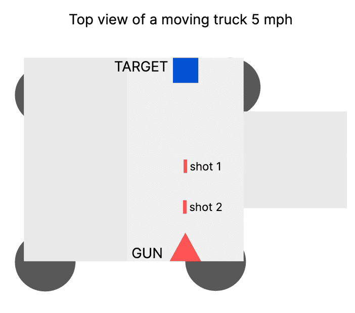

i'll simplify the question. If this doesnt work. Then i give up. Tell me on which step the logic breaks down.
Analysis below is based on the image. Assume that the distance between the gun and the laser is far enough so that it can be measured.
Step 1
In the image the truck is moving at 5mph. Lasers are fired in quick succession. In this case, both lasers hit the surface of the blue moving target. The target is moving because the truck is moving from left to right at 5mph. I Am not talking about relative frame of reference, i am talking about the actual spot on the blue surface the laser hits. Question for step 1: Will the lasers hit the exact same spot on the blue surface? I say no, but that the different between shot1's actual hit, and shot2's actual hit will be tiny. What do you say? And why?
Step 2
Assume the truck speeds up to 1000 miles per hour.
Question for step 2: Will the lasers hit the exact same spot on the blue surface? I also say no, but that the different will be more noticeable. What do you say? and why?
We can tell the actual spot on the blue surface the laser hits by physically looking at the burn marks.
Also, i say, that the faster the truck moves towards the speed of light, the more noticeable the distance of the burn marks will be.

Always the same spot will be hit, regardless the (constant) speed of the truck. Else this experiment could be used to measure an absolute speed of the truck, which is not possible according to the principle of relativity.
Of course they will, because the gun and the target are attached to the truck so they're in the exact same relationship both times the trigger is pulled. You've done the exact same thing twice, so they'll hit in the exact same place. You can easily write down the equations of motion using the Lorentz transforms and demonstrate that this is the case.
You continue to explain as if you believe there's some absolute frame of reference in which light moves in a special way. That has been known to be a wrong model for over a century.

This matches the interpretation of the problem that I posted back in #24
We have a laser pointed straight up. We have a target directly above the laser. Both are mounted in a cart that is moving.
Two shots are fired in succession. If we pretend that the cart is at rest, we expect that both shots will strike the target dead center.
If we drop the pretense that the cart is at rest, your expectation appears to be that each shot will traverse an "actually vertical" (vertical in the ground rest frame) spatial path which misses the center of the target. You should naturally expect that both shots will miss the target by the same margin.
Your expectation is incorrect due to relativistic aberration as pointed out by others. Both pulses will emerge from the laser at an angle. In the case of a laser gun, this is the result of the relativity of simultaneity applied across the laser wave front. The leading edge of the pulse (the edge in the direction of the cart's travel) will be emitted a fraction of a second after the trailing edge. The result is a slanted wave front and a slanted direction of travel for each laser pulse.
In the case of collimation by use of a black painted vertical rifle barrel the same aberration angle is found because the only laser pulses that can successfully traverse the rifle barrel are ones at that exact same angle -- the angle that leads the target by exactly enough for a dead center hit.
