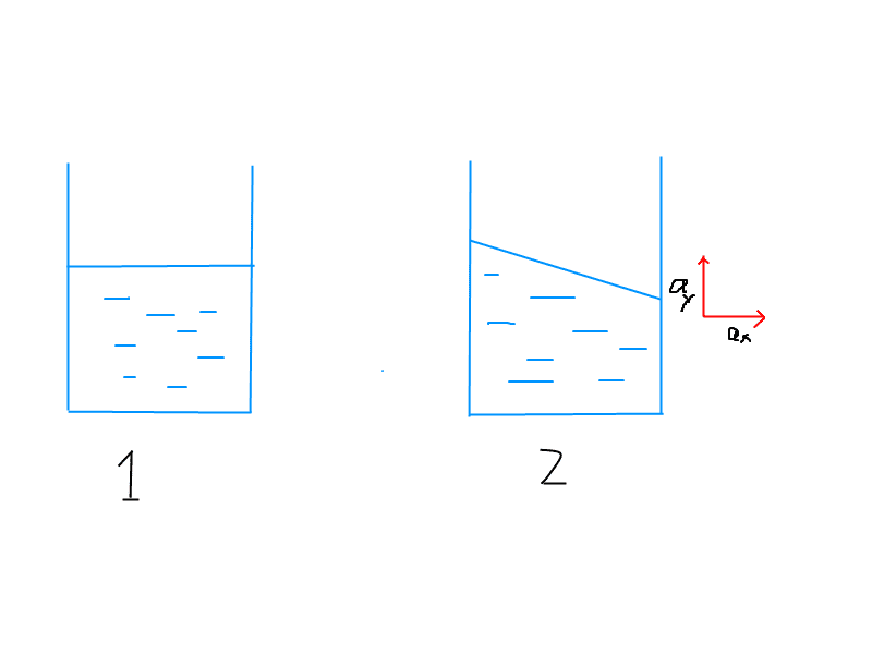

Suppose a lift is moving in a shaft upwards with a velocity a. Then why does the net acceleration of the lift become (a+g)? Life suppose a liquid of denisty ρ is kept at rest in a beaker. In this case as pressure changes only in horizontal direction so we can write:
dP/dx=0 and dP/dy=-ρg
But, soppose the beaker is accelerated and it has components of acceleration ax and ay in the x and y directions respectively, the above above equations in this case reduce to
dP/dx=-ρax
dP/dy=-p(g+ay)
Why does addition of accelerations in the y-direction happen? Shouldn't we subtract g from ay as both of them are in opposite directions?
I am posting two attachments. First one is for an accelerating cart with a bob hanging inside it.
Second is for an accelerating beaker with liquid inside it. I want to know why does the liquid incline from top left to down bottom when we accelerate the beaker towards the right. Is it analogous to cart situation in any way? If yes then how?

hi andyrk! :smile:
yes
in both cases, you can draw a force diagram in the accelerating frame of reference
in both cases, the acceleration (of the bob or of the water) is zero
in both cases, there is the actual gravity, mg vertically downwards
in both cases, there is a fictional force, -ma, opposite to the rest-frame acceleration a
so there is a total force mg -ma, downward and to the left in both cases, which you can think of as being an "effective gravity" …
the effective gravity makes the bob point down and left, and make the water surface perpendicular to that :wink:​

Speaking strictly in terms of Newtonian mechanics (not relativity), It doesn't. :smile: The "net" acceleration is a, because it is implied that the net force acting on the lift is ma (if it was any different, the lift would be accelerating at some other rate besides a).
Newton's second law states,
[tex]m \vec a = \sum_n \vec F_n[/tex]
meaning an object's mass times its [net] acceleration is the sum of all forces acting on that object.
In our lift example, can you quantify all the forces involved that are acting on the lift? A free body diagram (FBD) might help. One of the forces has a magnitude mg (where m is the mass of the lift and its contents), pointing down. There is another force involved pointing up (presumably from the tension of the cable). What is the magnitude of this other force? (Hint: it's not ma.)
dP/dx=-ρax
dP/dy=-p(g+ay)
Sounds reasonable so far.
It's still Newton's second law again, however this time it's distributed through the liquid.
Don't confuse the net force, and thus the "a" in the net ma, with the individual forces involved.
In order for the beaker and contents to accelerate at [itex]\vec a = a_x \ \hat x + a_y \ \hat y[/itex], there must be some other force involved besides just [itex]-mg \ \hat y[/itex]. If you quantify that other force, I think the answer will become more clear.

Can you explain it without using pseudo forces? Pseudo forces is a made up concept firstly. So it doesn't actually answer it completely logically.
yes:
if the real forces are F, and the acceleration of the vehicle (etc) is a and and the acceleration of the bob (etc) is b,
then in the accelerated frame of reference Newton's second law for the bob is
F - ma = mb​
(because relative acccelerations add)
but in the rest frame, it is
F = m(b + a) :wink:​
