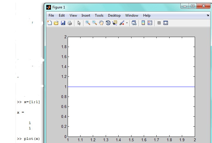

I have attached a picture of my problem to this thread. When I plot the column vector
x=[1;1]
I get a straight line instead of a point, does anyone know how to fix this?

Code:
plot(x,y);
where (x,y) is a point.
To show points, also:
Code:
plot(x,y 'o');
jhae2.718 said:
Code:
plot(x,y);
Code:
plot(x,y 'o');
Thanks but for this assignment I have to plot the x column vector that I get from doing another calculation that I did not show. Maybe I can extract the numbers out of the column but we have not been taught that.
plot(x(1),x(2));
for multiple elements,
plot(x(1, :), x(2, :))
