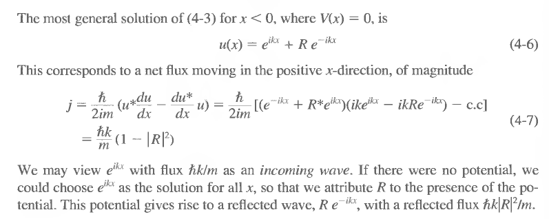

Solve the time-independent Schrödinger equation in one dimension for a potential step, i.e. V(x) = 0 for x<0 and V(x) = V_0 for x>0.
- \frac{\hbar^2}{2m} \frac{d^2u(x)}{dx^2} + V(x)u(x) = Eu(x)
Rewrite as (4-3)
<br /> \frac{d^2u(x)}{dx^2} + \frac{2m}{\hbar^2}( E - V(x) )u(x) =<br /> \frac{d^2u(x)}{dx^2} + k^2( 1 - V(x)/E )u(x) = 0<br />
Looking at x<0, i.e. V(x)=0:
<br /> \frac{d^2u(x)}{dx^2} + k^2u(x) = 0<br /> \Leftrightarrow u(x) = Ae^{ikx} + Be^{ikx}<br />
The derivation in my textbook claims, at this step:
Is it implicit that all multiples of the suggested u(x) are solutions (for x<0)? Furthermore, from the paragraph on the probability flux, it looks like |R(x)| < 1. Why?
It seems like I'm missing some assumption. Why would the x<0 case be different from the case of a free particle?

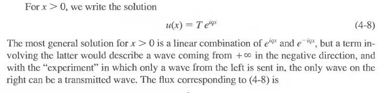

Edit: I'm having a similar problem with x>0.
Gasiorowicz talks about the waves having a direction. What is meant by this? Why is the term e^-iqx dismissed?

If you apply the momentum operator
\hat{p}=\frac{\hbar}{i}\frac{\partial}{\partial x}
to the state ψ(x)=eikx, you get
\hat{p}\psi(x) = \frac{\hbar}{i}\frac{\partial}{\partial x}e^{ikx} = (\hbar k)\psi(x)
This tells you ψ(x) is a momentum eigenstate, where the momentum of the particle is equal to \hbar k.
In both regions, the general solution is of the form Aeikx+Be-ikx, which you can, in light of the above, interpret as particles moving in the positive direction and negative direction. Now it's essentially a matter of applying boundary conditions. In this particular problem, you're interested in what happens if a particle is incident on the potential step when coming from the left. You would expect a reflected wave, in the x<0 region, and a transmitted wave, in the x>0 region. Consequently, you keep both terms for x<0, one representing the incident wave and one representing the reflected wave. For x>0, you only have the transmitted wave, so you drop the e-ikx term.
Much clearer! Looking at the momentum makes it more concrete. Thank you very much.
