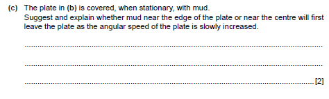

Why does the mud fly off tangentially from a rotating plate?
23 replies · 4K views
PhysicStud01
174
centripetal force F = mrw^2
the answer says that it is the one at the edge because F is greater since r is greater.
but should the force be inwards, why would the mud leave the plate. what force acts on it. can someone help

Think in terms of what holds a piece of mud onto the plate as it starts to spin. Let's call that force "mud sticky force". :smile:
Which location--edge or center--requires more "mud sticky force" as the plate starts to spin? Sooner or later, the existing "mud sticky force" will not be enough to keep the piece of mud stuck. Where will that limit be reached first?

Think of there being a force preventing a piece of mud from sliding around, analogous to friction. The force will be horizontal. But it is not infinitely strong--sooner or later it won't be enough to hold the mud in place.

Don't get hung up on the details of this force. At the root, it will be an electromagnetic force. (So is friction.) The main idea is that something must be exerting a horizontal force on the mud so it can move in a circle.

Don't think of "centripetal force" as a separate force; it's just a generic name. The actual force creating the centripetal acceleration is the horizontal force that we are talking about. The "mud force" is the centripetal force!

Consider Newton's 1st law. The mud "wants" to keep going straight, but the sticky forces from the table are preventing that, forcing it to move in a circle along with the rotating plate. Up to a point.
Centripetal force is not an applied force. If a body is moving in an arc, there must be a force acting on it to achieve that. If you add up all the forces acting on the body, and take the component of that which is orthogonal to the current velocity, that is the centripetal force.
A body with no forces acting on it moves in a straight line at constant speed. If no horizontal forces act on the mud it will move in a straight line off the edge of the plate.
In order for the mud to stay where it is on the rotating plate, it requires a centripetal force. The question is, where does that force come from, and will it be enough to stop the mud sliding off?

What about static friction? Relative motion is not required.

The centripetal force required to maintain circular motion is greater than at the edge. That is correct. The maximum force of static friction is what it is. It is constant everywhere on the plate.
The mud slides off the rotating plate if the centripetal force that is required to maintain circular motion is greater than the maximum force that static friction can supply.
The mud slides off the tilted plate if the component of gravity parallel to the plate is greater than the maximum force that static friction can supply.
+ in the exampe you give, the mud would move if tilted enough. but if the tilt is not change, it may remain still. now, in this case of the question above, the normal reaction is actually constnat.
If you stand on a rotating merry-go-round you have to lean inward to stay in position. If you stand at the center you do not have to lean in at all. If you stand farther toward the edge, do you have to lean inward at a steeper angle in order to keep your balance?

You are still thinking of centripetal force as though it is an applied force. It is the force that would be needed to keep it on the plate. If the friction is not strong enough to provide the necessary centripetal force then the mud will slide off. The required centripetal force is greatest at the greatest radius. Does the available frictional force depend on the radius?

Because it is not a strong enough force towards the centre.

It doesn't require a force to move it out. As I reminded you earlier, if there is no force acting on a moving body then it will move at constant velocity. That means, at the same speed and in the same straight line. Moving in a straight line will take it off the plate.
If there is some frictional force, but not enough, it will move in an arc, but at too great a radius compared to its position on the plate, so it will still slid off.

If you have learned about frames of reference then the "outward" motion is because you are adopting a rotating frame of reference rather than an inertial reference frame. But it seems unlikely that you have learned about frames of reference yet.
As viewed by someone standing on the ground and watching the plate, the mud does not slide outward. Each blob of mud flies off tangentially -- maintaining its current speed and direction. Since the mud was moving while it was on the plate, it continues moving after it has flaked off.
It flakes off when the force of friction is not sufficient to keep accelerating it in a circular path any longer.
