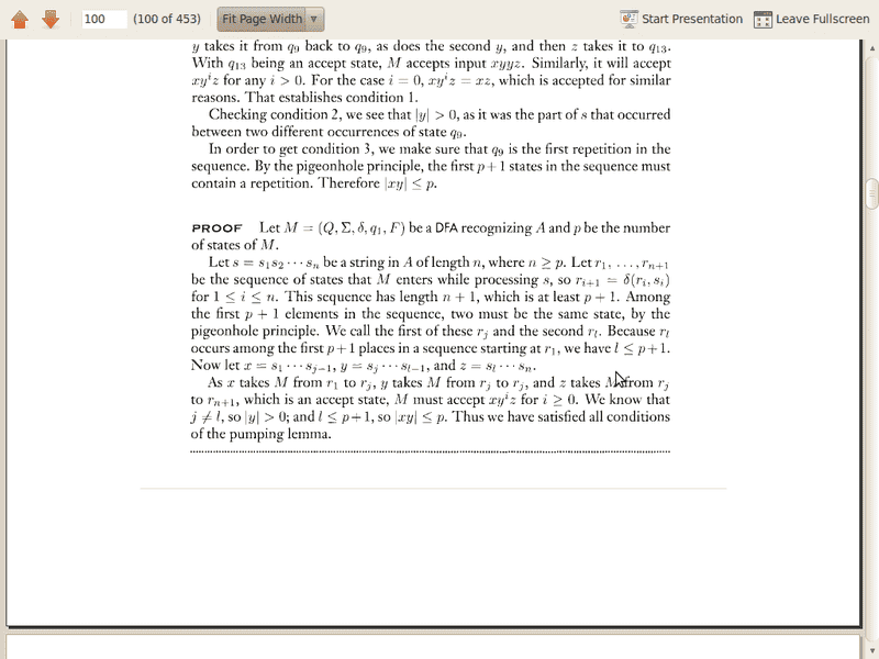

It says that |xy| < p. But I don't understand why even after reading the proof. If I have a four state DFA, whose last state is the one that is going to repeat for a given input string of length p, |x| is already going to be four, since it represents the states necessary to reach the repetition state. So in this worst case scenery, |x| is already equal to p, so with |y|>0 we already have |xy|>p. SO what's wrong with my line of thought
If I understand correctly, the pumping lemma gives you a number, p, such that a bunch of stuff happens. Can you reference the exact pumping lemma you are talking about?
I am sorry, I forgot that there is more than one pumping lemma so I aborted the copy that I was doing. Very clever from my part. Anyway I attached a screenshot of the proof:
  • Scanned textbook page with the end of a pumping lemma proof for regular languages, using a DFA with p states and the pigeonhole principle to split a string into x, y, z with |xy| ≤ p.
