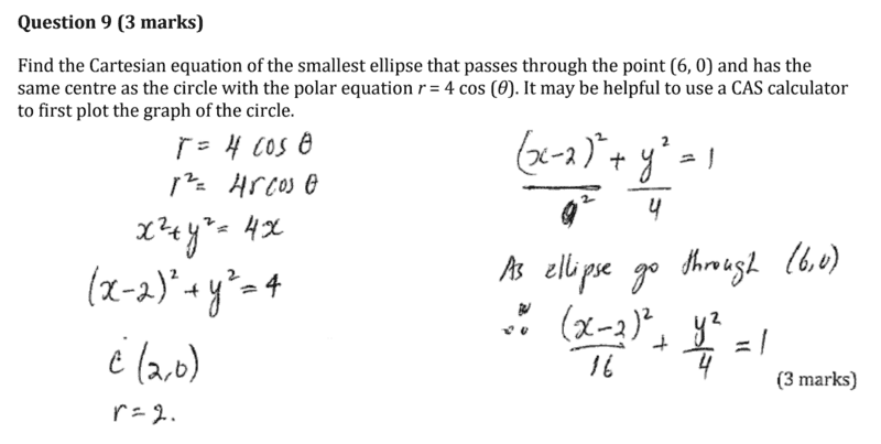

Find the Cartesian equation of the smallest ellipse that passes through the point (6,0) and has a centre at (2,0).
x^2/a^2 + y^2/b^2 = 1
Hi everyone
The solution for this question has b^2 as 4, but I don't see why it has to be 4. I've tried using different values of b for the ellipse on Desmos, and it is possible to make ellipses with smaller values of b that pass through (6,0).
Have I missed something in the question? Or has the question omitted an assumption (e.g. that the ellipse has to have the same height as the circle)?Thanks
Handwritten working for a CAS question: polar r = 4 cos θ converted to x² + y² = 4x, then (x-2)² + y² = 4, centre (2,0), r = 2; ellipse (x-2)²/a² + y²/b² = 1 with b² = 4, then the point (6,0) substituted giving (x-2)²/16 + y²/4 = 1.

Define 'smaller' in this context!
Maybe you should describe in words what the smallest ellipse will be! Where on the ellipse must ##(6,0)## lie?

You are correct There seems to be a problem with the question (Post #1 attachment).
I guess the question should also require that the ellipse fully encloses the circle, or something equivalent to this.

The width of the ellipse would be constrained by having to pass through (6,0), so smaller to me would refer to its height. I'm not sure there's a limit to how flat the ellipse could be. I think b could be made arbitrarily small and the ellipse would still pass through (6,0), so long as a^2 = 16.

Yes, I imagined a flat line from ##(6,0)## to ##(-2,0),## too. So either @Steve4Physics is right and it was a typo, or some additional information is missing. I won't care very much.

I think you're right, the centre and xmax are defined, but you need another condition else the min height and area are 0.
