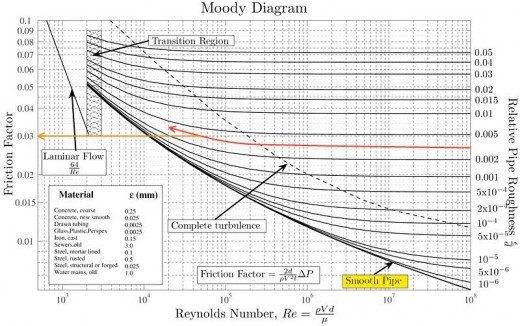

Why is complete turbulence independent of Reynolds number?
4 replies · 6K views
werson tan
183
why the author gave that the complete turbulenece is indpendent on the Reynold number ?
For the turbulence to occur , the Reynold number must be higher than certain value , am i right . So , IMO , turbulenet is dependent on the Reynold number
You're not correctly comprehending what this slide is saying.
First, it's discussing the friction factor f as it's plotted on the Moody diagram:
In the zone where the flow is completely turbulent, i.e. to the right of the dashed line, the friction factor is constant w.r.t. the Reynolds number. In this region, the friction factor f depends on the relative pipe roughness only.

Can you explain this phenomenon?
You can read a more detailed explanation here:
https://www.uio.no/studier/emner/matnat/math/MEK4450/h11/undervisningsmateriale/modul-5/Pipeflow_intro.pdf
this is the book that i use . can you expalin why during the complete turbulent , it is independent of reynold number ?
