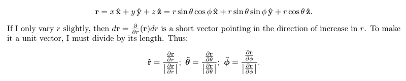

I read that ##d/dx## is the direction that x increases (paraphrased from Griffiths e-mag). Why is this? I can't find any information online when I search this up.
Original text:
That's essentially the definition of a unit vector associated with a coordinate. For curvilinear coordinates, of course, it's only exact in the differential limit. A small increase in ##\theta##, say, with no change in ##r## or ##\phi## means a small change in the ##\hat \theta## direction.
How do we know that it is the direction that x increases, as opposed to x decreasing?

What is the vector? I take it the vector is ##\frac{\partial \bf{r}}{\partial r}##. Also isn't it $$d\mathbf{r} = \frac{\partial \mathbf{r}}{\partial r} dr + \frac{\partial \mathbf{r}}{\partial \theta} d\theta + \frac{\partial \mathbf{r}}{\partial \phi} d\phi$$
laser1 said:
(From Griffiths).
Why does that not make sense? The only confusion is that ##\mathbf r## is not to be confused with the coordinate ##r##. In any case:
$$\frac{\partial \bf{r}}{\partial r} = \sin \theta \cos \phi \bf{\hat x} + \sin \theta \sin \phi \bf{\hat y} + \cos \theta \bf{\hat z}$$Which is how we would define ##\bf{\hat r}## geometrically as the increasing radial direction. Likewise:
$$\frac{\partial \bf{r}}{\partial \theta} = r(\cos \theta \cos \phi \bf{\hat x} + \cos \theta \sin \phi \bf{\hat y} - \sin \theta \bf{\hat z})$$Which, you can check is the direction of increasing ##\theta##.

Ok, what about if vector r is <x, y, z>. So ##\partial \mathbf{r} / \partial x = \hat{i}## which is in direction of increasing x! Does the same logic apply to spherical and polar?
Yes.

Ok, I tried checking this and I have kind of satisfied myself. Taking the partial derivative with respect to e.g. ##\theta## does point in the direction of increasing ##\theta##, i.e. anticlockwise. What I now want to understand is why does taking the derivative do this? I understand that, with a partial, you are only changing one thing, but why does taking the derivative point in the increasing variable direction as opposed to decreasing?
Earlier you answered "by definition", but I am not sure what you meant exactly.
Go back to the limit definition of the derivative and consider the difference quotient. In what direction does the numerator point when you increase ##\theta## by a small amount?

The definition of the partial derivative (of anything , call it ##f##) wrt ##\theta## is
\frac{\partial f}{\partial \theta} = \lim_{h\to 0}\left(
\frac{f(r,\theta+h,\varphi) -f(r,\theta,\varphi)}{h}
\right)
In particular, if you let ##f## be the position vector then the numerator is the difference of the position vectors given by coordinates ##(r,\theta+h,\varphi)## and ##(r,\theta,\varphi)##. For positive ##h## this therefore points from ##\theta## to ##\theta+h > \theta##, ie, towards larger values of ##\theta##. For negative ##h## the numerator points towards smaller ##\theta##, but the denominator is also negative.

What we have, in general, is the definition of a unit vector based on the position vector ##\vec r##. Let's use two general, orthogonal curvilinear coordinate ##u, v##. We define the unit vector by:
$$\hat u = \frac 1 {h_u} \frac{\partial \vec r}{\partial u}$$Where ##h_u = \big |\frac{\partial \vec r}{\partial u}\big |##. Using this definition, we can express the gradient of a function in these coordinates:
$$\vec \nabla f = \frac 1 {h_u}\frac{\partial f}{\partial u}\hat u + \frac 1 {h_v}\frac{\partial f}{\partial v}\hat v$$In particular, we can take the gradient of the coordinate ##u##:
$$\vec \nabla u = \frac 1 {h_u}\hat u = \frac 1 {h_u^2} \frac{\partial \vec r}{\partial u}$$The gradient is the direction of greatest increase of a function, hence the greatest increase in ##u## is in the direction of the unit vector so defined.
This won't apply in non-orthogonal (skew) curvilinear coordinates.
