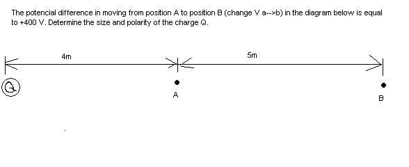

Hi. I'am having trouble with 2 of my homework problems. Usually I do pretty good in physics but electrostatics unit turned out to be very confusing for me. I think I figured out all the other homework questions but these 2. I drew those out myself but I think they are pretty understandable.
P.S. I'am also confused by Q. What exacly is Q and how it is defined? Any input will be appriciated. Thank you.
  • Diagram of two point charges on a line: q1 = 20 µC at left and q2 at right, 10 m apart, with point P 6 m from q1 between them; the question asks for the size and polarity of q2 given a field of 8500 N/C to the right at P.
  • Diagram of a charge Q on a horizontal line, with point A 4 m to its right and point B 5 m further right; the text states the potential difference from A to B is +400 V.
What equations have you been given for working with the electric field from a distribution of point charges (the Q's)? And what is the relationship between voltage potential difference and the electric field?
