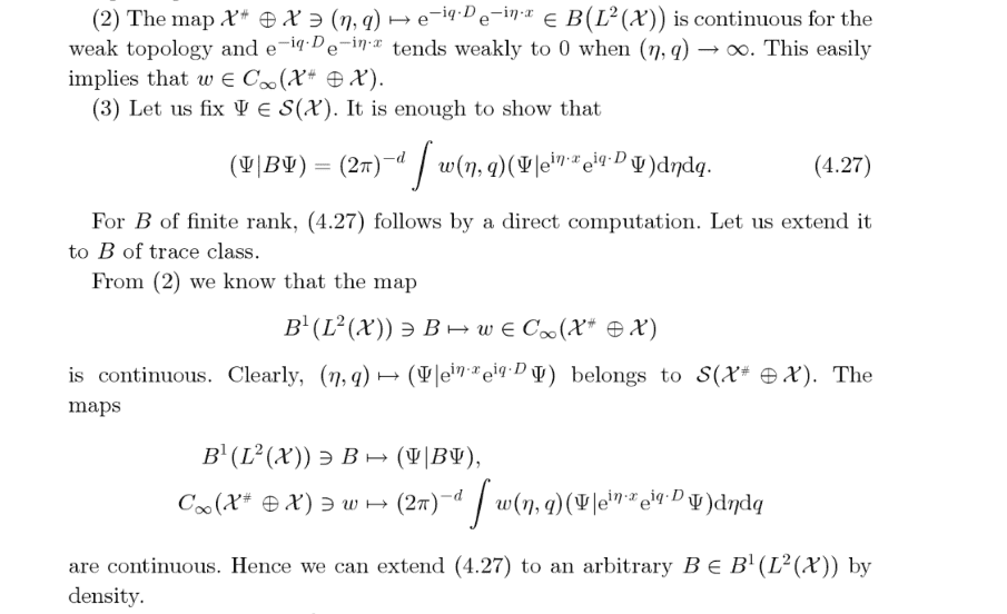

i read this equality (4.26) here w depends on two variables. it is written that if B is bounded (L2) then it is a quadratic form identity on S. what does it mean? is it related to the two variables?
next the author writes that if w is continuous in the variable we have an identity operator on L2(X). does il mean that for every vector the two terms give a same result? how to prove that?

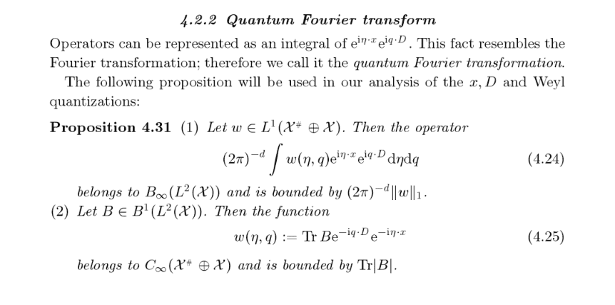

https://books.google.fr/books?id=uZdNtduC5NAC&pg=PA103#v=onepage&q&f=false
Printed textbook page, section 4.2.2 Quantum Fourier transform, with Proposition 4.31 stating two claims about an integral operator and a trace function, numbered equations (4.24) and (4.25).
Printed page 103 from a mathematics text on Weyl operators, showing item (3) with equation (4.26): B = (2π)^(-d) times the integral of w(η, q) e^(iη·x) e^(iq·D) dη dq, with the phrase 'as a quadratic form identity on S(X)' highlighted in yellow, followed by item (4) and Remark 4.32.

Does it mean in the first case that we have a same way to associate a complex number to each couple f1, f2 of function? the dirac notation would be <f1|B|f2>
and in the second case the same function noted B|f> ?
