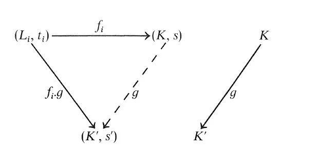

##\textit{Structure is Abstract.}## If ##f:K\rightarrow L## is an isomorphism in ##\mathscr{K}## then for all ##t\in \mathscr{C}(L)## there exists unique ##s\in \mathscr{C}(K)## such that ##f:s\rightarrow t## and ##f^{-1}:t\rightarrow s.## optimal; that is, specifically, if whenever ##(K',s')## is a ##\mathscr{C-}##structure and ##g:K\rightarrow K'## is a ##\mathscr{K-}##morphism such that (please see the following image)
##f_i\circ g## is admissible for all ##i## then ##g## is also admissible.
