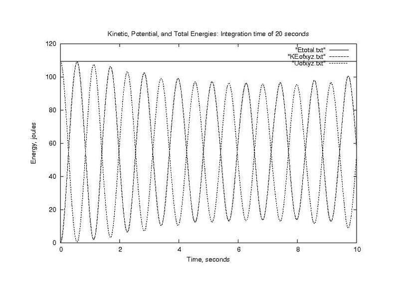

One would expect a plot of the total energy, call it E, to be constant right? Am I going crazy?
[tex] <br /> E = KE(\dot{x},\dot{y},\dot{z}) + U(x,y,z)<br /> [/tex]
where U(x,y,z) is the potential energy function of the springs based on how far the mass is displaced from the origin (0,0,0). I'm getting a strange oscillating total energy. It seems as if not all of the potential energy is not being converted to kinetic energy.

If there are no external forces than energy should be conserved.
If your time-marching solution was not conserving energy, most likely the amplitude of the motion would increase with time, or die away to zero.
So I would guess your energy calculations are wrong.
Try making the model simpler, so you know what the "correct" answers are. For example set the springs in the Y and Z directions to zero and simulate
1. Oscillation along the X axis (simple harmonic motion)
2. Oscillation along the Y axis with springs in the X direction only. This is not simple harmonic motion, but you can check that the strain energy in the springs at the maximum displacement is correct.
It's fixed. I re-derived all three Lagrangian equations -- What a pain in the neck! Here is the fixed energy plot.. but the title is wrong, it's 10 seconds.
Thanks Alephzero.
