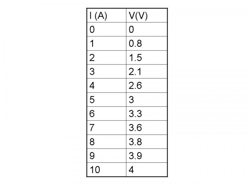

A student is given a circuit containing a variable power supply, a resistor, and an ammeter all in series, and a voltmeter attached across the resistor. The student is then asked to determine, as accurately as possible, the resistance of the resistor.
Knowing that Ohm's Law stated that V=IR, the student made a series of measurement of potential difference (V) versus current (I) on the resistor. The student end up with this data set:
Using Ohm's Law, he knows that the slope or gradent of PD versus I will give him the resistance of the resistor. He then enters these numbers into his data analysis program, runs a linear line fit routine, and it spits out the value of the slope that he wants, which is ~0.4 Ohm.
Sounds alright, doesn't it? However, there is one MAJOR problem with this. Can you describe what it is? You may assume that the voltmeter, ammeter, and power supply are "ideal", meaning they do not contribute to the accuracy or inaccuracy of the measured values. (2 points)
Hint: plot it.
Vanadium 50 said:
Hint: plot it.
it's non-linear. The plot is supposed to be linear.
Therefore the data is bogus.
I believe that was what Zapper was trying to tell us.
[ZapperZ] 2:42 pm: You guys went way too deep into this by giving the reason on why the curve isn't a straight line.
[ZapperZ] 2:42 pm: You don't have such info... all you have is the data.
[ZapperZ] 2:42 pm: The problem here is that the student was trying to fit a STRAIGHT LINE to a curve that isn't straight!
[ZapperZ] 2:43 pm: The straight line fit does not represent what the data looks like.
[ZapperZ] 2:43 pm: The numerical software will fit anything it is given and spits an answer, but it doesn't mean that the answer has any meaning.
The data isn't bogus. Data is data. It is the analysis that isn't valid. It is trying to make the data to conform to something which it isn't, which is a straight line.
You're making an assumption that isn't necessarily true.
Question to ponder: would you expect the temperature of the resistor to change, as the current and voltage are increased?
I don't think I have a 40 watt resistor in the house. Unless of course you count my 40 watt antique warming globe.
But yes, of course the temperature will rise, with real world consequences.
And I think the question caught me off guard, as in my 40 years of electrical experience, I've never measured resistance in such a manner. I always use an ohmmeter.
But I think Zappers ultimate point was that you shouldn't blindly plug data into a piece of software without looking at the data, to see if the software's output really makes sense.
