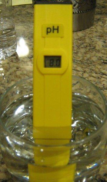

I am trying to make my own alkaline water using baking soda and distilled water.
First I measure out 0.018 moles of baking soda as follows
(0.25 tsp)(1ml/.202 tst)(1.2 grams NaHCO3/ml)(1 mole NHCO3/1 gram NaHCO3) = .018 moles NaHCo3
I measure out 0.236 liters of distilled water i.e. 1 cup.
The molarity of the NaHCO3 is not M= 0.018 moles NaHCO3/0.236 liters of water = 0.076
The pOH of the solution is –log(0.076) = 1.12 thefore the pH is 14 – 1.12 = 12.88.
Note: the molarity of [OH] should be the same as the molarity of NaHCO3.
However, when I put ¼ tsp baking soda into as cup of distilled water the pH measures only 8.0.
What is wrong here? Is the baking soda not disassociating?

pH of 8, as you measured, IS ALKALINE.

This is incorrect. You have to consider the equilibrium constant of the reaction between bicarbonate and water.

Again, write out the relevant chemical equation. Dissociation of Na+ from HCO3- is not what produces OH-.

I am afraid you are misunderstanding why the pH of the solution changes. NaHCO3 is fully dissociated into Na+ and HCO3-, of these only HCO3- is responsible for pH changes - partially because it dissociates further, partially because it hydrolyzes.

No, HCO3- doesn't dissociate the way you wrote. When it dissociates it produces H+ and CO32-, so if anything it lowers the pH during the dissociation, not makes it rise.
Please read on Bronsted-Lowry theory of acids and bases.

No, sodium bicarb is not that basic in solution, it is a weak base.
