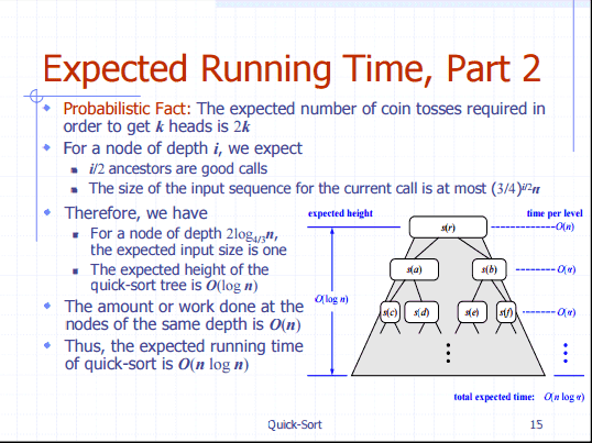

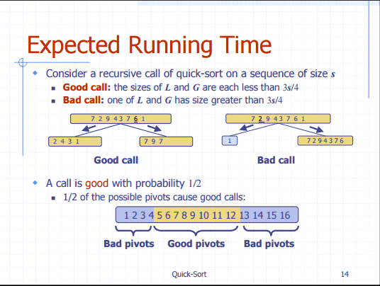

Hello! (Wave)
View attachment 4423I am trying to understand the proof that the expected running time of quick-sort is $O(n \log n)$.
Could you maybe explain it to me?
  • Slide titled Expected Running Time showing a good call and a bad call in quicksort, with a row of numbers 1 to 16 split into bad, good and bad pivot ranges, and the note that a call is good with probability 1/2.
  • Slide titled Expected Running Time, Part 2 listing bullet points on coin tosses and quick-sort depth, with a tree diagram of quick-sort recursion levels, each marked O(n), and expected height O(log n).
