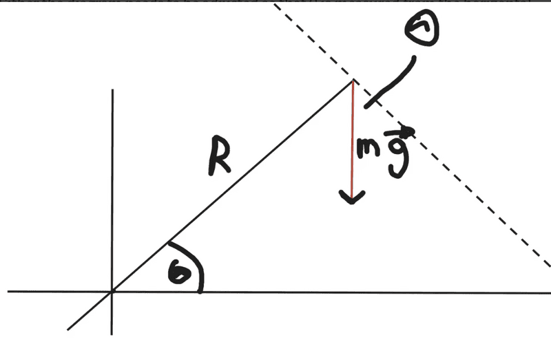

Hey! In this setup, https://sciencedemonstrations.fas.harvard.edu/presentations/falling-faster-g ,a board rotating about a fixed axis under gravity, The board's angle θ is measured from the horizontal, Angular acceleration is given by α = MgRcosθ / I Then we're asked to find the acceleration of the free end of the board in the downward direction. The solution provided uses a = αLcosθ for the downward acceleration. However, I'm puzzled about something: Shouldn't we also consider the downward component of this radial acceleration of the end point too? I missing something.
Thanks in advance for any insights!
Hand-drawn diagram of a rod pivoting from the origin at angle θ above the horizontal, with length R, a downward weight mg drawn in red at the free end, and a dashed line marking the direction of the end's motion.
The acceleration calculated in this case is in the direction tangential to the line of the rod. The magnitude of this acceleration is ##\alpha L##. The vertical component, therefore, is ##\alpha L \cos \theta##, as given.
The acceleration at the rod's end can be divided into radial and tangential components.
However, I’m still unclear on why only the tangential component is considered when discussing vertical acceleration. Shouldn’t the radial component also contribute to the vertical direction? What am I missing?
I think you're right! The vertical acceleration is greater than that calculated.
The point is this. The radial acceleration depends on the speed of the rod (##L\dot \theta^2##). If you release the rod from rest, then the critical angle is as on the page. At that angle, the rod will immediately accelerate vertically faster than gravity.
If you release the rod from a greater angle, then it will initially accelerate vertically less than gravity, but will exceed gravity before it reaches the above critical angle - due, as you say, to the radial component, which itself has a downwards vertical component.
Well spotted!

momo1111 said:
By ‘critical angle,’ do you mean a specific angle at which the board, when released from rest, will immediately start accelerating vertically faster than gravity? At such an angle, the radial acceleration doesn't contribute to the total acceleration of the mass?
Yes. Initially the velocity is zero, so there is zero radial acceleration.
The page you linked to is wrong, in that it assumes that there continues to be zero radial acceleration, even when the board is moving.
momo1111 said:
My line of reasoning is (a simple one),
The correct approach is to use the equation for acceleration in polar coordinates, which is:
$$\vec a = (\ddot r - r\dot\theta^2)\hat r + (r\ddot \theta + 2\dot r \dot \theta) \hat \theta$$In this case, we have the constraint that ##r = R## is constant, so the equation reduces to:
$$\vec a = (- R\dot\theta^2) \hat r + (R\ddot \theta) \hat \theta$$And, initial acceleration when the board is released from rest is:$$\vec a_0 = (R\ddot \theta) \hat \theta$$It's this equation that leads to the analysis on the page you linked to, where only the tangential/angular acceleration is considered.
Now, we can transform these accelerations using:
$$\hat r = \cos \theta \hat x + \sin \theta \hat y, \ \hat \theta = -\sin \theta \hat x + \cos \theta \hat y$$To give:
$$\vec a_0 = (R\ddot \theta)(-\sin \theta \hat x + \cos \theta \hat y) = (-R\ddot \theta \sin \theta) \hat x +(R\ddot \theta \cos \theta) \hat y$$Finally, in this case we have ##\alpha = -\ddot \theta##, so we have an initial vertial component of acceleration:
$$\ddot y_0 = -R\alpha\cos \theta$$PS I'll leave it as an exercise for you to calculate the expression for the vertical acceleration more generally, after the rod has started moving.
