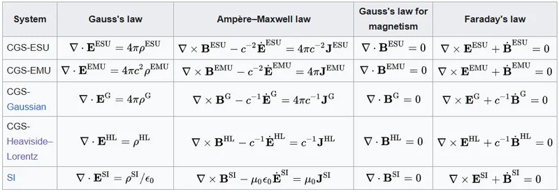

martinbn said:
What is the big difference between SI and cgs?
Maxwell's equations are different in SI vs CGS units. The best source for that is this table from Wikipedia: https://en.wikipedia.org/wiki/Centi...ensions_of_the_CGS_system_to_electromagnetism
So basically, in cgs units neither ##\mu_0## nor ##\epsilon_0## exist. All of the coefficients in Maxwells equations are powers of ##c##.
martinbn said:
I see, so the real difference is the extensions to electromagnetism.
Yes. Ignoring the sizes of the base units, both systems have base units with dimensions of mass, length, and time. But cgs uses only those mechanical base units for electromagnetism while SI introduces a new base unit with dimensions of electrical current.

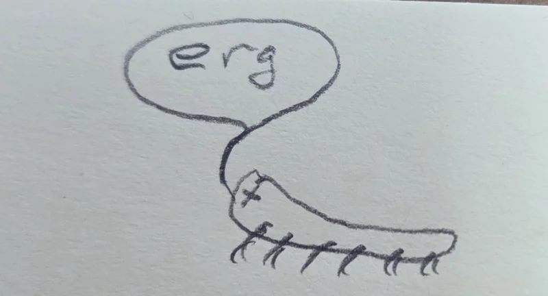

I have never forgotten the memory aid my professor drew up on the blackboard, something like this:
"a dying centimeter says, 'erg' "
  • Haha
