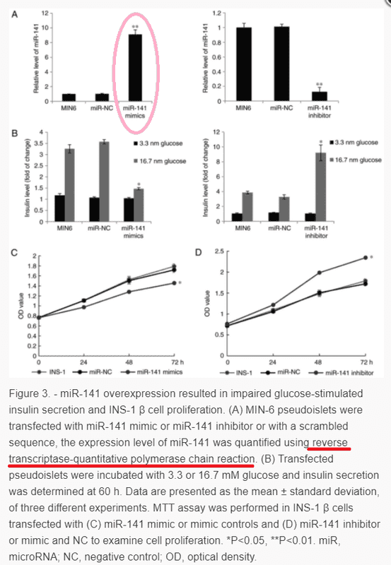

Why is the miRNA expression increasing?

Four-panel figure: A and B bar charts of miR-141 level and insulin level for MIN6, miR-NC and miR-141 mimics or inhibitor, C and D line graphs of OD value over 0 to 72 h for INS-1 cells. Caption mentions reverse transcriptase-quantitative polymerase chain reaction.
As presented in Fig. 3A, the expression of miR-141 was increased in the miR-141 mimic transfection group and the increase in miR-141 led to a significantly impaired insulin secretion at 16.7 mM glucose (P<0.05; Fig. 3B)
Source: paper
When the cells were transfected with miRNA-mimic it increased the miRNA expression. Is this increase due to the activity of RNA-dependent RNA polymerase, which generates secondary miRNAs?
AFAIK, mouse or humans don't have RDRPs to amplify small RNAs. It's likely that the RT-qPCR is detecting the miRNA mimics in addition to the endogenous miRNA.
