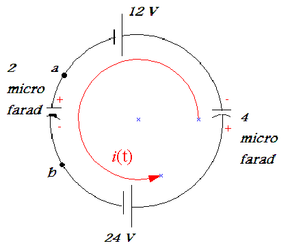

See the image : http://postimg.org/image/hswmylvz1/
In the image, potential of point a is Va and that of point b is Vb. We have to find out Va-Vb for the circuit as shown in the image.
Let the potential of negative terminal of the 12 V battery be 0, and its positive terminal's potential be 12 V. Similarly let potential of positive terminal of 24 V battery be 24 V and negative terminal be 0 V. Then potential of a, Va = 0 and potential of b, Vb=0, and so Va-Vb=0, but this is wrong. :(
Also, I already got the answer by Kirchoff's loop law, but I wanted to know why above procedure is wrong. Also is the circuit in parallels or in series ?
Please help !
Thanks in advance.. :smile:
For a given circuit there can be only one reference point for potential. You've tried to make the negative pole of both batteries separate zero references. This is equivalent to shorting points a and b, eliminating the capacitor in between.

4V on the larger capacitor, and 8V on the smaller, since we can assume they have been given identical charge.
Here is my solution. Hope you can check it.
Let's call the left capacitor is C1 and the right one is C2.
Apply KVL for the loop:
Vc1 - 24 + Vc2 + 12 = 0 where Vc1 = Vab
or
Vc1 + Vc2 = 12 V
Because C1 and C2 are in series: Vc1/Vc2 = C2/C1 = 4/2 = 2
Hence, Vc1 = Vab = 8V, Vc2 = 4V.

The net potential from the sources would indicate that the initial current will be counterclockwise (the 24V supply dominates). That will drive the top plate of the 2μF capacitor (where "a" is located) positive, and the bottom plate of the 4μF capacitor positive, too.
Circuit schematic of a closed loop with a 12 V battery on top, a 24 V battery at the bottom, a 2 microfarad capacitor on the left and a 4 microfarad capacitor on the right; points a and b are marked on the left side and a red arrow labelled i(t) shows current circulating in the loop.
  • Circuit schematic of a closed loop containing a 12 V battery at top, a 24 V battery at bottom, a 2 microfarad capacitor on the left with points a and b marked on either side, and a 4 microfarad capacitor on the right, with a red arrow labeled i(t) circulating counterclockwise inside the loop.
Circuit diagram of a closed loop with a 12 V battery at top and a 24 V battery at bottom, a 2 microfarad capacitor on the left and a 4 microfarad capacitor on the right, with points a and b on the left branch and a red arrow showing current i(t) circulating clockwise.
But the book gives the answer that Va-Vb=-8 V. There is the minus sign, as per the author of the book, where I have taken this question.

I don't see why a minus sign would come here. Definitely a is at a higher potential than b.
You don't need to find the effective capacitance here. The question asks the potential difference across the 2 micro farad capacitor. You have a "effective" battery of 12 V here. Can you find the potential difference across the two capacitors?

Okay, well if you allow the lesson from KVL that tells us the order of potential changes around an isolated loop is irrelevant, then we can shuffle the order of the components (this is equivalent to algebraically reordering the terms in a sum, which we know makes no difference to the total). Group the voltage sources together and capacitors together. Then you have a net voltage source and two capacitors which are clearly in series and you can employ the capacitor potential divider rule.
I cannot understand. Sorry.. :(
It may depend upon how the author defines his terminology for Vab. Is it the potential at a with respect to b, or the potential at b with respect to a? That'll give you a sign difference.
Ok. Firstly we should assume these capacitors are completely charged. So, we cannot talk about any current in the circuit (the charges don't jump the capacitors).
Secondly, the 24 V power supply is greater than the other one. Then, we must assume that Va > Vb and the "minus sign" of book answer must be wrong.
I think it's been done to death but this is how I'd do it..
Let V2 be the voltage on C2 (the 2uF) and V4 be the voltage on C4 (the 4uF) and +ve is defined as per gneil's version of the drawing.
Then applying KVL clockwise from "b" says..
V2 + 12 + V4 + (-24) = 0
So
V2 + V4 = 12

Now V2 = Va-Vb so
Va-Vb = 8V
However the problem doesn't actually say the caps were discharged so that assumption should be stated in the answer. If you don't make that assumption then all you can say is that
V2 + V4 = 12
and you can't give an answer for Va-Vb.

Ok thanks !
I missed the convention that voltage difference along the direction of current is taken as negative while applying KVL. So that is why Va-Vb=-8 V...
