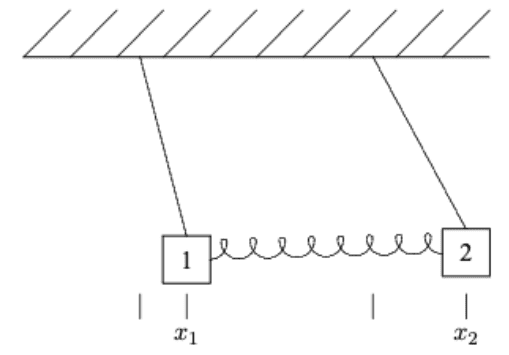

Consider a system of coupled pendulums.
Below we see a picture of this
The masses are ##m_1## and ##m_2##.
We measure the displacements of each mass as follows
When the blocks move horizontally, they will move vertically as well, because the length of the pendulums remains fixed. Because vertical displacement is second order in the ##x_j##'s,
$$y_j\approx \frac{x_j^2}{2}\tag{1}$$
we can ignore it in thinking about the spring.
Where does (1) come from?
If ##L## is the pendulum length and angle ##\theta## is relative to the vertical, write an expression for ##y## as a function of ##\theta##. Apply the small angle approximation. Note that ##x\approx L\theta.## What do you get?

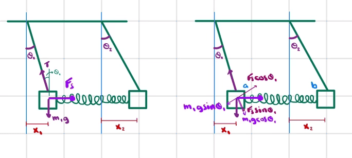

I did the following
$$T\cos{\theta_i}-m_ig=m_i\ddot{y}$$
$$\cos{\theta_i}=\frac{l-y_i}{l}=1-\frac{y_i}{l}\approx 1$$
$$\sin{\theta_i}=\frac{x_i}{l}\implies x_i\approx l\theta_i$$
We can also consider the radial and tangential components
$$m_ig\cos{\theta_i}-T+F_s\sin{\theta_i}=-m_il\dot{\theta_i}^2$$
$$m_ig\sin{\theta_i}-F_s\cos{\theta_i}=m_il\ddot{\theta_i}$$

zenterix said:
I did the following
$$\cos{\theta_i}=\frac{l-y_i}{l}=1-\frac{y_i}{l}$$
Start from ##y=L(1-\cos\theta)##. This expression is exact. What is ##\cos\theta## for small values of ##\theta##?
$$y_i=l(1-\cos{\theta_i})\approx 0$$
since ##\cos{\theta}\approx 1##.
If we do a second order approximation of cosine we get
$$\cos{\theta_i}=1-\frac{y_i}{l}\approx1-\frac{\theta_i^2}{2}$$
$$\implies y_i\approx \frac{l\theta_i^2}{2}\approx\frac{lx_i^2}{2l^2}=\frac{x_i^2}{2l}$$
