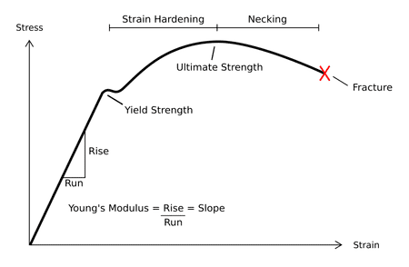

Why is Young's modulous in units of Pascals? I mean 200 GPa for steel.
Young's modulus is the ratio stress/strain.
dimension of stress is same as that of pressure since stress = F/A and strain is dimensionless since strain = change in length/initial length

Here is a typical stress - strain curve for a ductile material.
The elastic modulus, in this case Young's Modulus for tension, is just the slope of the line in the elastic region. The slope has units of stress / strain and is then usually expressed as Pascals for the SI system, or in psi for the English system. Depending upon which system of units one uses, Young's modulus references a 1 meter length of material, or a one inch length of material.
Since we are dealing with stress, the area of the material become irrelevant.

The "standard displacement" is a strain of 1, which means doubling the length. Obviously, not all materials can be stretched that far and their maximal stress is less than their Young's modulus, so you won't be able to observe the stress value given by the Young's modulus in every material.
