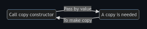

Your options are call by reference and call by value. Call by value works by creating a copy. Your can't do that without a copy constructor, so you can''t do that when writing a copy constructor.

Because if it's not by reference, it's by value. To do that you make a copy, and to do that you call the copy constructor. But to do that, we need to make a new value, so we call the copy constructor, and so on...

The issue with this is the "first creates a copy" part, which by itself would call the copy constructor, which would require creating a parameter copy first, which would call the copy constructor, which would require creating a parameter copy first... and so on.
In theory this could be solved internally by not using the user defined copy constructor in this special case for the parameter to the user defined copy constructor itself, but rather some default copy constructor. But why bother introducing such special cases and exceptions, just to allow something that is inefficient anyway? You should always pass by reference to avoid unnecessary copies.
