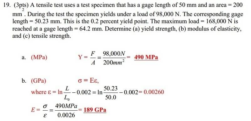

I am trying to wrap my head around this and for some reason I am blocked. I have taken Solid mechanics and strength of materials and am always used to calculating strain as ε=ΔL/L. I might be missing something easy as it has been a year since the class but in my Manufacturing Engineering class the professor went over an example that went like this:
During tensile test a specimen yields at 48KN. This is the .2% yield point.
Ao= .1m^2
Lo = .05m
Lf = .0523m
We calculate yield stress at normal with 48KN/.1m^2 = 480MPa
Then when we went to calculate Youngs Modulus (E = σ/ε), we used (ε - .002) for the ε. I feel like I am missing something. I think I know why we used this, I just wanted some clarification.
Basically E is the slope of the elastic curve. Dropping straight down on the stress strain curve gives the regular ε. If we offset this by .002 we can get the rise/run needed to get E. right?
Thanks,
Chuck

The 0.002 would be the elongation at a particular stress. What stress did you use?
480Mpa
E is the slope of the elastic curve which is linear up to the proportional limit, where stress is proportional to strain, and you can calculate this from the yield stress and the elongation at that stress. Dropping down from the curve gives you the elongation.
Right, but what they are having us do is calculate E from the .2% yield strength, where the force, lengths, and area is given.
So we find the strain for that stress(which is past the proportional limit) with ΔL/Lo, subtract .002 from it, then divide the stress by the new strain.
I uploaded an example that is using true strain, but the same concept of subtracting .002.
Its just basically using the slope equation I thought. (y2-y1)/(x2-x1) which is in this case:
(480MPa - 0)/(.0046 - .002)...or am I just way off?
That should be the equation for calculating E by the 0.2% offset. I do not see reason why that would not be so.
PS. I must have interpreted what you were explaining in your first post.
PS. 0.2% yield point is kind of arbitrary. On certain stress strain diagram one can see where the specimen does yield. Other materials are chosen to have other offsets, or other methods to determine E, etc. As long as we all agree on terminology and its description then we are all OK.
