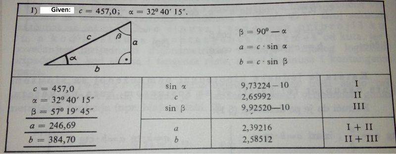

Can somebody please point me into a direction how to solve the attached trig problem?
First step, where can I find such values for sin (alpha)?Thanks.

You'd use a calculator to find the value of [itex]\sin(\alpha)[/itex]. The rest of the information can be inferred by what you've already been given (and with the use of a calculator). For example, you can find a since you know c and [itex]\alpha[/itex], you can also find [itex]\beta[/itex] since you know [itex]\alpha[/itex], and hence you can finally find b since you know c and [itex]\beta[/itex].

I know I can use a calculator :), but I would like to know how to solve it in a manner that is given on a photo.
There must be some tables that I should use (i assume), but i don't know which one.
Also, the value of c in step II, where did that come from?

On the right side they give the logarithms (to base 10) of the values.
For example ##\log_{10}(c)=\log_{10}(457)=2.65992...##

It depends on how much accuracy you want. You can just google search "sine table" and you'll find plenty of tables that offer each degree from 0 to 90, but assuming you want more accuracy since you're given angles that involves minutes and seconds too, in the case of [itex]\alpha[/itex] personally, I'd be satisfied with approximating [itex]\alpha = 32^o40'15''[/itex] into [itex]\alpha \approx 32\frac{2}{3}^o[/itex] and just calculate [itex]\frac{1}{3}\sin(32^o)+\frac{2}{3}\sin(33^o)[/itex]. If this doesn't make sense for you, then have a look at linear interpolation: https://en.wikipedia.org/wiki/Mathematical_table

I have no idea. The values in those boxes don't coincide with what the given values of c and alpha at the top were. I wouldn't dwell too heavily on it though since you can quite easily re-do that entire page for yourself with the correct values.

But i am wondering, why use logarithms?

That's how we solved this kind of problems when I was in high school many many years ago, just before calculators became ubiquitous. :wink:
We had tables that gave logarithms, the trigonometric values, their logarithms, ...
We used them to look up the values, and logarithms were used to convert multiplications into additions.
