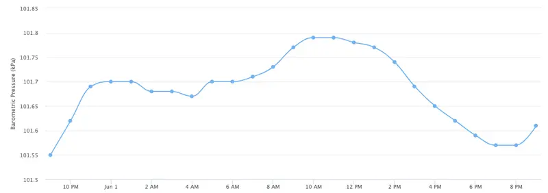

When displaying atmospheric pressure, weather apps show absolute pressure. I understand that it is the definition, but usually the atmosphere is at 1 atm ##\pm## corrections of the order of 1% or 0.1%. Such changes are what matters. Would it not be better to use differential pressure put 1 atm at zero and show variations around that?
Here is an example for Paris:
Clearly the the scale is trimmed to avoid this issue but it shows that we do not need such a ridiculous scale on the left.

This graph seems to provide what you ask for, namely a plot of the variation over time where people uninterested in the absolute pressure values just look at the curve to get a sense of how pressure varies over time and people who somehow benefit from knowing the corresponding absolute pressure can then read specific values off the scale.
Are you complaining that the graph include the extra numbers on the left? I mean, if the plot was made insisting that the scale should include zero pressure, then I would agree it would be ridiculous.

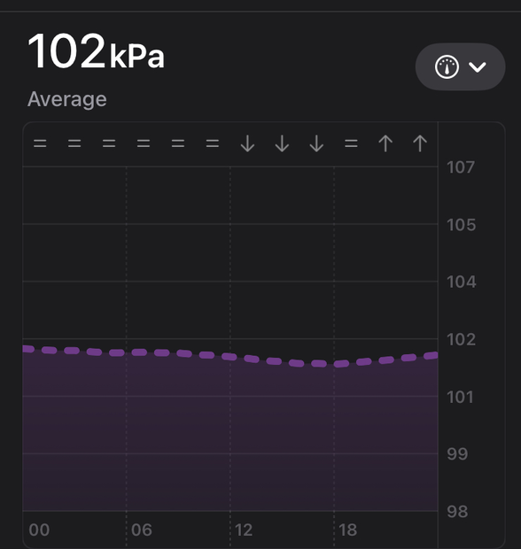

The thing is that this is what my app looks like:
The drop indicated a sudden thunderstorm, barely noticeable with this scale.

I'll give you that's a terrible scale (sometimes 1kpa, sometimes 2, all the same spacing?) but creating a brand new way of expressing pressure (and having to teach it to people) just as a workaround for one bad app seems like overkill to me. Better to just find/write a better app.
I have a couple of apps that I use and both say the trend in words but neither show it graphically. And I feel like pressure has somewhat been superseded by radar for short term forecasting.

I believe that you have an app problem, not a units problem.
