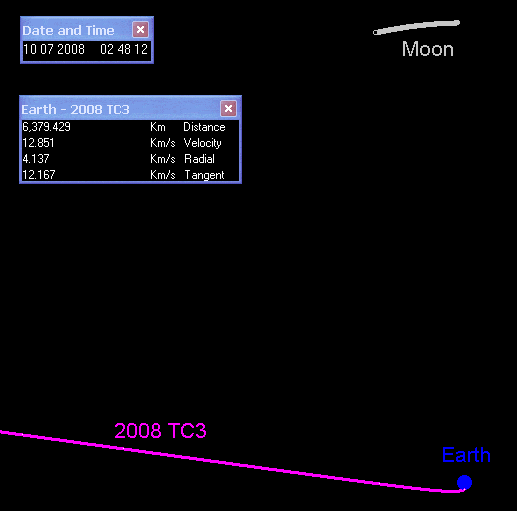

It's being reported in the minor planet mailing list that Sudan will be hit tommorow by an object not large enough to cause any damage. But this may be the first instance of an impact being predicted at all.
http://tech.groups.yahoo.com/group/mpml/message/21070
This image was generated with Gravity Simulator, using data from JPL Horizons and http://www.cfa.harvard.edu/mpec/K08/K08T50.html. It shows an impact at 02:48:12 with the bolide colliding with Earth at a speed of 12.851 km/s

Here's JPL's page mentioning a location...
JPL confirmed that an atmospheric impact will very likely occur during early morning twilight over northern Sudan, north-eastern Africa, at 2:46 UT Tuesday morning. The fireball, which could be brilliant, will travel west to east (from azimuth = 281 degrees) at a relative atmospheric impact velocity of 12.8 km/s and arrive at a very low angle (19 degrees) to the local horizon. It is very unlikely that any sizable fragments will survive passage through the Earth's atmosphere.

All the reports were saying it was coming in at 12.8 km/sec. It released an energy about 1.1 to 2.1 kT of TNT. It was also reported to have been 3 meters across.
We've got v, we've 1/2*mv2, and we've got the volume. This gives us the density: solve for M and then divide by the volume.
Presumably this thing is irregular, so a sphere is probably going to be generous. Let's call it spherical and have its energy be the high end of the range (it's more likely to be 1.6 kT with a nonspherical and therefore less massive shape)
2.1kT = 8.8*1012 J
mv2 = 1.8*1013 J
v2 = 128002, which makes
m = 110000 kg
Volume = pi*4/3*r3, where r = 1.5: 7780 kg/m3
Most asteroid densities are g/cm3, which would be 7.8 g/cm3
