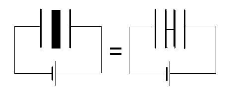

A metal plate, which is d1=0.5mm in thickness, is put in parallel between the electrodes of a capacitor. Surface area of capacitor's electrodes is S=100cm2 and distance d between them is 2mm. What is the work that is needed to be done to remove the metal plate when capacitor is: a) disconnected from the source; b) connected to the source? The voltage of this source is U=100V.

If you put a metal plate between two other ones then you have to capacitors instead of one. What is the capacitance of each of them? How are they connected?

Then they are connected in series. I think each one of those two capacitors has a capacitance of [tex]C=\frac{2\epsilon_{0}S}{d-d_{1}}[/tex]
Yes, correct! And what is the resultant capacitance of these two series connected ones?
ehild
Great! The resultant capacitance should be [tex]C=\frac{4\epsilon_{0}S}{d-d_{1}}[/tex]
I believe the energy is now [tex]W=\frac{2\epsilon_{0}S}{d-d_{1}}U^{2}[/tex]
Then maybe the work that is to be done is the difference of energy that the capacitor contains with and without the inserted plate?
Yes, the difference of the energy is equal to the work done on the capacitor. If it is disconnected from the battery after it has been charged, the only work is done by the person who pulls out the plate. In this case, the charge stays the same on the plates. If the plates are connected to the battery, the voltage is unchanged and the charge will be different. Both the man and the battery does work.
