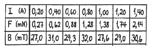

A 0.02 meters long conductor is placed perpendicular in a homogen magnetic field.
Current through the conductor is changed. And we have measured the data here:
How can we write the magnetic flux density the correct way?
How do I know how many digits my answer should have?
F=I*l*B
After calculating the B (F/(I*0.02)) one by one from the table above (e.g. like: 1,1 / (1,0*0,02) = 0,055 ), I got these numbers:

Your input values are to 2 significant figures, so your answer should also be to two sig figs which means that 59 is correct. However, I would take the mean or average as opposed to using half the difference between min and max. What if you have a single outlier on the high side, say around 80 mT? It's a good bet that your uncertainties follow a normal distribution; you have enough data points to calculate the standard deviation from the mean as an estimate of your uncertainty.

So when writing (A ± c), the A is the "mean", and c is the standard deviation.
This is what's shown as "solution to a physics problem" to a website of a high-school physics book.
I and F are taken from a table, B values are calculated (length of the conductor is 0.0500 m).
They first find the mean, which is (27.00 + 31.0 + 29.3 + 32.0 + 27.6 + 29.0 + 30.6) / 7 = 29.5 ≈ 30
Then they just find the (1/2)*(Bmax-Bmin) which is: 0.5*(32.0 - 27.0) = 2.5 ≈ 3
They write: B = (30 ± 3) mT
Is it correct to calculate that way? Or should we use standard deviation?
But when taking the standard deviation, what I got is:
√(((29.5-27.00)^2+ (29.5-31.0)^2 + (29.5-29.3)^2 + (29.5-32.0)^2 + (29.5-27.6)^2 + (29.5-29.0)^2 + (29.5-30.6)^2) / 7) = 1.68 ≈ 2
so B = (30 ± 2) mTMy other question is: it's only in the final result we count the significant digits?
Neither.
Even if the same scatter persists, the more datapoints you have the more precisely you know the true value. Taking max - min is especially wrong since the more samples you have the greater that difference is likely to be.
If your sample of n datapoints has a standard deviation σ then the standard error of the mean is approximately σ/√n.

So we should write that way:
(Mean ± (σ/√n)) ?

Maybe ½(max - min) used in the high school book to keep it simple and easy for that level.
(Mean ± (σ/√n)) ?
σ: standard deviation
n: number if samples
Yes.
That is a crude way of estimating the standard deviation in the (theoretical) population of infinitely many samples, but it is completely wrong for estimating the error in the calculated mean from n samples.
As I noted, it would tend to increase the more samples you took!
½(max - min) /√(n-1) might be ok. The -1 is needed. Consider taking only one sample. ½(max - min) = 0, whereas you really have no idea what the error is. ½(max - min) /√(n-1) = 0/0, which correctly reflects the utter uncertainty.

If you were to plot the data on a graph you would use the rounding error, ±0.05, to set the error bars.
The division is still troublesome in this regard: the division also divides the uncertainty, so now each ratio has a different error range.
To cope with this, you should use regression analysis to find the slope rather than averaging the individual ratios. But you would want to fix (0,0) as a required intercept for the graph. I.e. you calculate the slope as ##m=\frac{\Sigma y_ix_i}{\Sigma x_i^2}##. This gives a mean of 60.65, not 59.
The standard error in the slope is ##\sqrt{\frac{\Sigma(y_i-mx_i)^2}{(\Sigma x_i^2)(n-2)}}##, which, after the division by 0.02, is about 1.37.
See e.g. http://www.statisticshowto.com/find-standard-error-regression-slope/ and https://en.wikipedia.org/wiki/Simple_linear_regression#Normality_assumption.
Note that the standard deviation of the errors yi-mxi is around 0.32, which dwarfs the ±0.05 rounding error. This means the 2-sig figs rounding error is irrelevant.
Putting all this together, you would be justified in quoting a result of 60.6±1.4.
