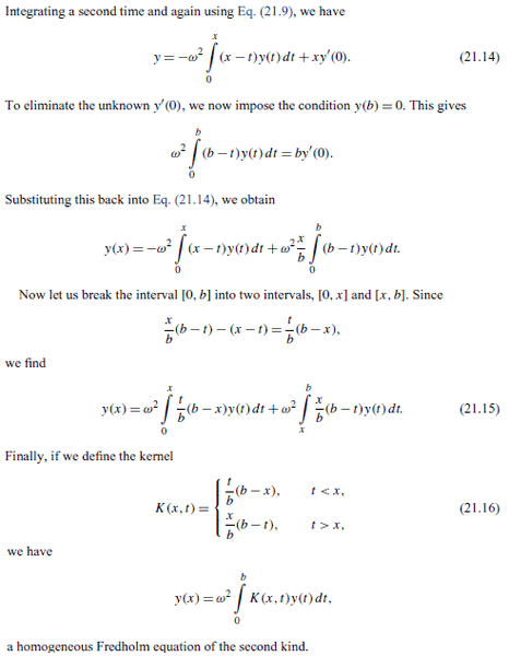

Is it possible to convert a general linear second order boundary value ode
[tex]y'' + P(x)y' + Q(x)y = g(x), y(a) = y_a, y(b) = y_b[/tex]
to a Fredholm integral equation, explicitly determining the Kernel in the process, without removing the [itex]y'[/itex] term? (Here is an example of doing it without the [itex]y'[/itex] term) I seem to be getting stuck.
My answer (computed below if necessary) is
[tex]y(x) = y_a+[\frac{y_b-y_a}{b-a}+\frac{1}{b-a}\int_a^bp(t)y(t)dt + \frac{1}{b-a}\int_a^b[q(t)-p'(t)](b-t)y(t)dt - \frac{1}{b-a}\int_a^bg(t)(b-t)dt](x-a)-\int_a^xp(t)y(t)dt - \int_a^x[q(t)-p'(t)](x-t)y(t)dt+\int_a^xg(t)(x-t)dt[/tex]
How do we write this in terms of an integral kernel, and can we call our result a Green function?
Note: Here is an example from Arfken of how it is done for the simple case of [itex]y''+\omega^2 y = 0, y(0)=0, y(b)=0[/itex]:
