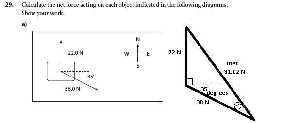

Calculate the net force acting on each object indicated in the following diagrams. Show your work.
The diagrams are in attachment, you don't have to download them to view them :)
c^2=a^2+b^2-2abCosC
c^2=√a^2+b^2
SOH CAH TOA
29a)
since we are given a 90 degree angle and the rest is 35 degrees, we can add
90+35
=125°
since we now have 2 sides of a triangle and the middle angle, we can use cosine to find the net force.
c^2=a^2+b^2-2abCosC
=(38)^2+(22)^2-2(38)(22)Cos125
=1444+484-1672Cos125
=1928-1672Cos125
=1928-959
c^2=√969
c=31.12 N
Fnet=31.12 N

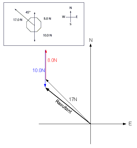

v This 29b) is the important one, because this is where I am not sure which solution is the right one.
29b)
Since one side of a line has 180 degrees, and we are given 45 degrees, one can assume 180-45 degrees would give you the angle on the left side of Z.
I attempted 29b) in 2 different ways, I am not sure which one is the better way and gives the correct solution.
In method 1: i deal only with the downward vector (10 N) and the north west vector (17N)
and since 180-45=135 we have the angle in the middle, which is 135 degrees.
so using this information i use the cosine law to find the net force.
c^2=a^2+b^2-2abCosC
=(17)^2+(10)^2-2(17)(10)cos135
=289+100-340cos135
=389-240.4
=√148.6
Fnet=12.19 N
Method 2: This method, looks at the entire diagram, and assumes its one big right angle triangle.
using the smaller right triangle, we find side x.
Sin45=opposite/hypotenuse
sin45=x/75
sin45(17)=x
12.02N = x
(other side we use the given, which is 8 Newtons + 10 Newtons = 18 Newtons)
now that we have every side besides the hypotenuse we use Pythagorean to find the hypotnuse which will give us the net force.
c=√a^2+b^2
=(18)^2+(12)^2
=√324+144
=√468
c=21.63N
Fnet = 21.63 N

What you are doing is vector subtraction, not vector addition.
um..what?
supernova1203 said:
um..what?
I only looked at your figures. The resultants you show in your figures are consistent with subtracting one of the vectors, in each part, rather than adding all the vectors for each part.
I appears that the numerical results you have for the magnitudes of the resultant forces is correct. If you also need the direction of the resultants, your figures will lead you to the wrong answer in each part.

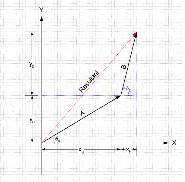

Vectors are added graphically by placing them tail to tip in sequence. The resultant is the vector from the origin to the tip of the final vector in the chain.

The result does not look right.
To mathematically do the equivalent of the graphical method, find the individual components of all the vectors (E-W components and N-S) components, corresponding to X and Y components on a Cartesian X-Y plot) and add the like components. Can you write the components of each vector? Make a vertical list of the x-components and another of the y-components. Add the columns to find the components of your resultant.

A picture is worth a thousand words :smile: Here's an example showing two vectors A and B being added. Each vector is specified by its magnitude (length) and angle to a reference direction, usually the positive X-axis. Note that vector B has its tail end placed at the tip end of vector A so that whatever quantities are represented by A and B applied successively. In other words, they are summed.
The resultant vector is the 'result' of adding A and B. The component of the resultant along the X-axis is equal to the sum of the X-components of A and B. Similarly, the Y-axis component of the resultant is equal to the sum of the Y-components of A and B. Use whatever trigonometry methods you know to extract the individual components.
##R_x = A_x + B_x##
##R_y = A_y + B_y##
##R = \sqrt{R_x^2 + R_x^2}##
##\theta_R = atan \left(\frac{R_y}{R_x}\right)~~~## note: beware of quadrant placement when dealing with negative valued components!

It is given that the 17 N vector makes an angle of 45° with respect to the +y axis (and because it's 45°, by symmetry it's also 45° from the -x axis). There's no particular "given" angle between a vector and some resultant that is the result of summing that vvector with a bunch of other vectors.
The procedure for summing vectors is to take each of the vectors individually and establish their x and y components. This is done using trigonometry and any angles you've been given that establish the vector's direction, and hence it's projections along the x and y axes of the coordinate system. The x components for each vector are summed to given the x component of the resultant. The y components for each vector are summed to given the y component of the resultant. These components define the result vector.
for the very first one (29a) since i know now that vectors are always added head/tail method, is the diagram i did incorrect? shouldn't it be 38 N vector, with the 22N vectors tail on the 38 N vectors head?
Yes.
shouldnt it be 38 N vector, with the 22N vectors tail on the 38 N vectors head?
Yes, or the 22N vector with the 38N vector tacked onto its head. The order does not matter.
