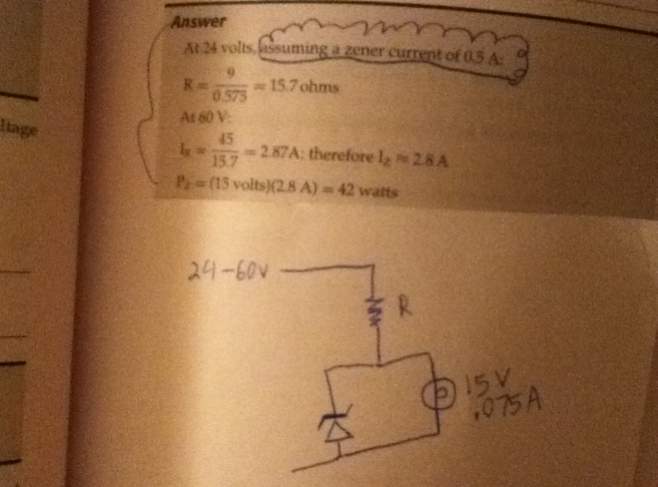

Hello, I'm trying to teach myself the basics of EE to kind of get an idea of what i'd do in college. I'm finding this question particularly troubling. Is this due to my low intelligence, or is it normal?
I've attached the photo of the problem. It is asking to find the power rating that the zener diode should have. Also, I included the answer that the book provides; the most confusing this is that it says the assume a zener current of .5 amps which doesn't make sense to me because I don't know how they came up with .5 amps. If any more info is needed let me know, thanks!
P=IV V=IR
I know that the zener diode must get the same voltage as the lamp because it is in parallel so it has 15V. For the resistor on top, I figured that it must have a voltage drop of 9 to 45 volts. However, even with this I am unable to find the current or resistance through the resistor. This is where I get stuck. The solution in gray says to assume a zener current of .5 amps, but I have no idea where this number comes from. Please help!
Don't know where you got this question but it is ridiculous.
The 15 volt zener needs to draw about 0.02A to be considered 'on'.
Additionally it needs to be able to cope with the lamp current, when the lamp is off or broken.
This is stated to be 0.075 amps
So the zener needs a standing current of 0.02 + 0.075 = 0.1 amps.
Power = volts x amps = 0.1 x 15 =1.5 watts say 2 watts for safety.
The idea of a zener is that it is (as you say) connected in parallel with the load (lamp) and it adjusts its own current draw so that the result is always 15 volts across it.
Thanks for the reply studiot. The answer says 42 watts so I am confused, why do you say it is ridiculous?
It's wrong.
It's wrong to choose 0.5 amps, that's way too much for the job.
But let us say that we did choose this standing current.
Then the wattage dissipated by the zener = 0.5 x 15 = 7.5 watts, not 42.

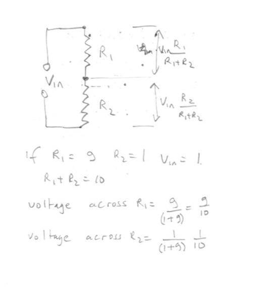

Do you understand what a potential (voltage) divider is?
Not quite sure... I'm fairly new to all this.
OK this is very important to learn as it is the basis of many circuit arrangements.
A voltage divider divides the input voltage in a defined ratio.
It is very simple - at its simplest it is just two resistors in series with the input voltage connected across them.
In my sketch I have shown this with an input of 1 volt the drop across the larger resistor is 90% of the voltage ie 0.9 volts.
In your circuit that is what is used.
Your input resistor is my R1
The parallel combination of the zener and the lamp is my R2
The object is to waste as little power as possible and the only component we really want to supply is the lamp.
Are you with me so far?

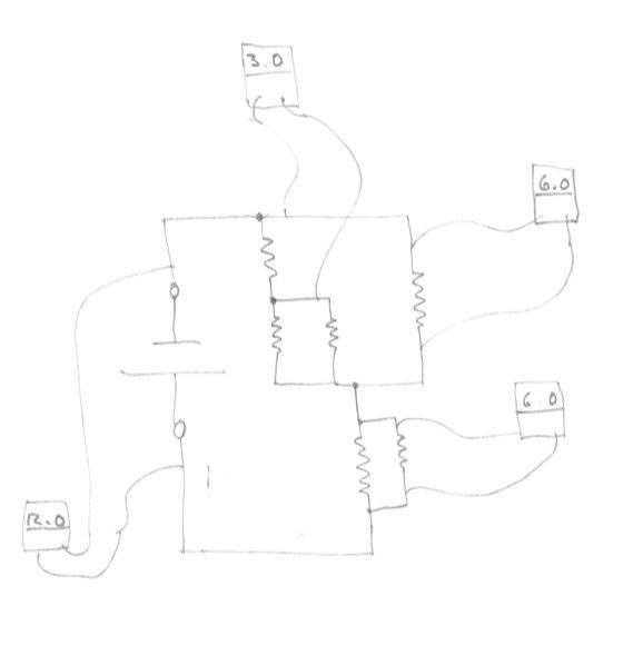

A voltage is what I measure with a voltmeter.
A voltmeter has two leads: you connect one to each of two different points in your circuit.
Here is a (slightly) more complicated arrangement to show what you would read on a voltmeter, connected at various locations.
